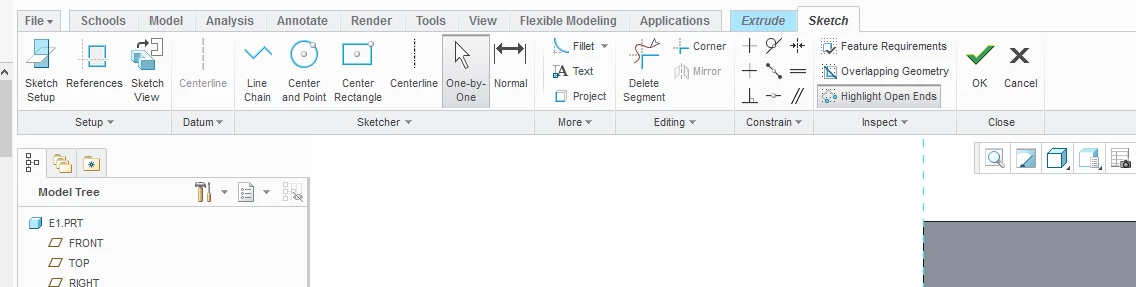

I am a rank beginner with this software, attempting to follow a basic tutorial. Can someone please tell me how to get the full set of options in the sketch tab? I have attached a screenshot of what I can access. I need all the other varieties of rectangles, ellipses, fillets etc.

    Hi, you have installed and configured Creo with the Schools Configuration. This creates a simplified view of the commands in the toolbars. If you want to reset Creo's toolbars back to its original settings, please read this discussion Restore Sketcher Ribbon UI in the Creo Schools Configuration‌

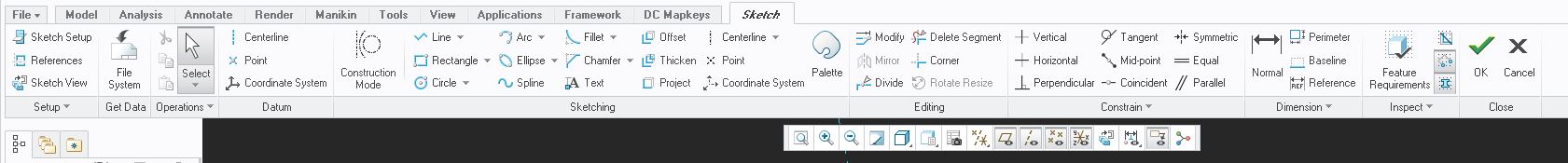

    Your ribbon looks different than mine from Creo Parametric 3.0:
    Note that my groupings are different than yours.

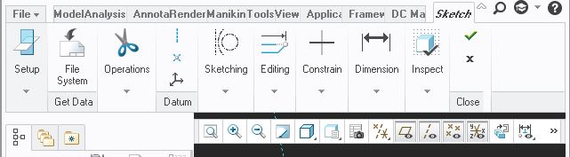

    I thought perhaps it was screen resolution causing changes, but even when I significantly narrow my Creo window, my groupings remain the same just extremely condensed:
    I've not made any changes to the sketcher ribbon since install.  Is it possible that an administrator has created a *.ui file that simplifies the ribbon?  Look for any *.ui files here:

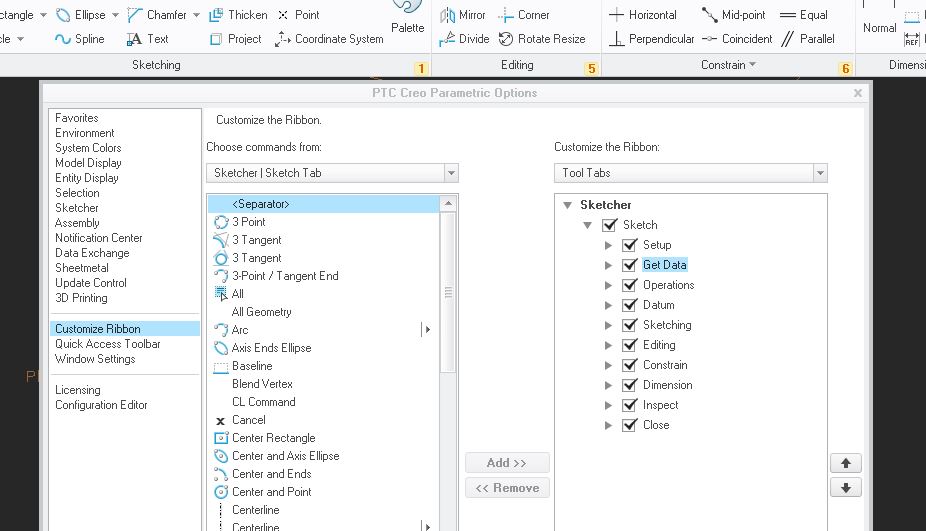

    It looks like you can control the visibility of ribbon items in Creo 3.  Within the sketch environment, right click on the ribbon and select "Customize the ribbon". You'll find yourself here:
    Note that you can check or uncheck different groups.  You can also add groups using the buttons at the bottom of this window (not shown in my screenshot).  Best I can figure, someone has customized this, either an admin or a prior user.  You can reset it here or if you remove the *.ui files, as I instructed above, you should restore the default.
