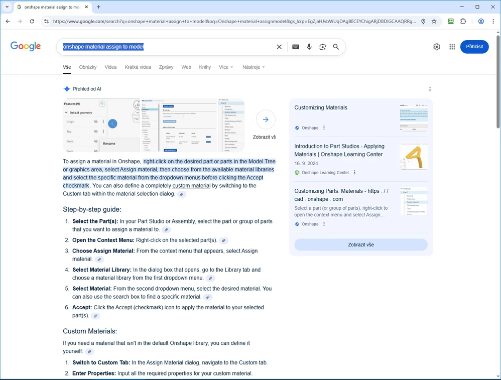

Oct 10, 2025 5:34 AM UTC
Hi.
Google ... onshape material assign to model
Oct 10, 2025 11:23 AM UTC
Hi Martin,
That is the way to assign materials, but in the private case of the FTC parts library, the parts already have all the material properties added to them so the resulting total mass of the robot will be accurate. That is why I assumed they are looking for materials on how to use the parts and not the material that the parts are made of, as that information is easy to find on the producer site (as the FTC parts are purchases).
