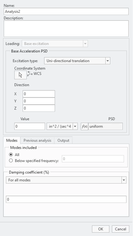

Now, I’m moving to the Random Vibration (PSD) Analysis and have a few questions I hope someone can help with:

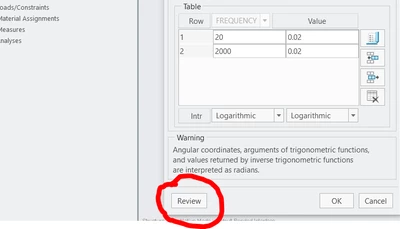

- I’m applying an enforced motion (base excitation) on the constrained rail surfaces, simulating the shaker input. Is this the right approach for replicating a vibration test inside a deployer?
- I used weighted links to connect the point masses to the payload mounting holes. The holes are not constrained (only the rails are). Is that correct, or should the payload attachment holes be constrained too?
- For the PSD table, should I use linear or logarithmic frequency spacing? The vibration profile is based on a launcher-provided spec. Where should I insert the values to get the results? (I pressed on f(x) under PSD and created my table with the launcher values. Is this the correct way?)

In Creo:
  • Using f(x) and entering the table manually with the launcher-provided frequency points is correct.
  • Enter exactly the breakpoints provided in the specification.
  • Do not over-interpolate unnecessarily.
Tip: Use Review to generate Graph of your inputs
So yes to your question
Using f(x) to input the PSD table is correct.
 Enter launcher spec values exactly as given.
 Logarithmic interpretation is appropriate.

What damping are you using?
Random response is highly sensitive to damping near resonance.
If damping is too low → unrealistic stresses.
If too high → unconservative.
Modal Mass Participation?---Note Random analysis depends entirely on modal completeness.
