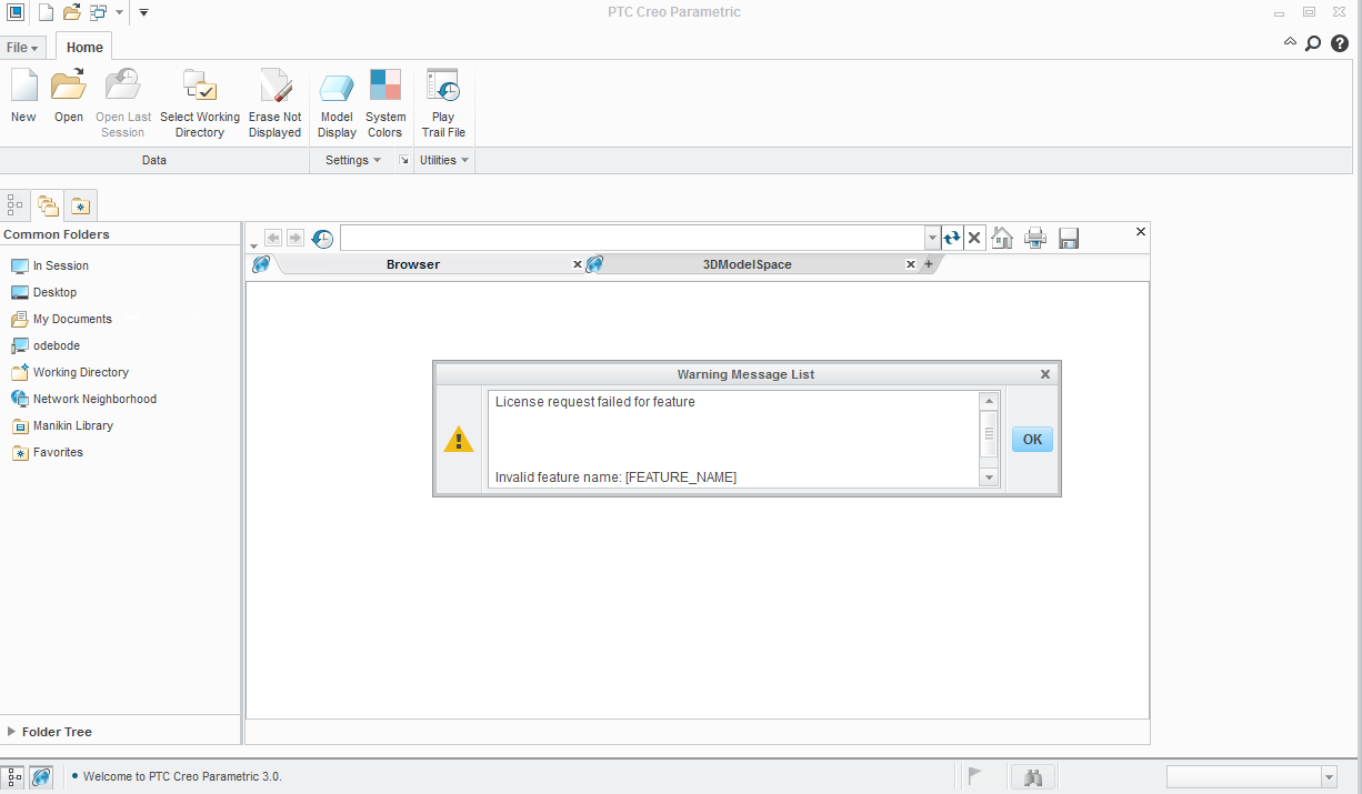

HI I just downloaded the creo 3.0 for students but accidentally skipped the licensing step and therefore cannot acces the program
  • September 15, 2015
  • 2 replies
  • 1174 views
I accidentally skipped the licensing step and this is what happens when I open parametric. Once I click "ok" it closes everything and I cant click any other thingCapture.PNG

    email you request to -
    -OR-
    enter your request on http://support.ptc.com/appserver/support/academic_case_logger/academic_case_logger.jsp
    Martin Hanak
    September 17, 2015
    Run the setup.exe again and follow the installation guide (insert product code and install the needed features).
    If after this you get the same error, please set the permissions on the installation folder (C:\Program Files\PTC\Creo 3.0) as full access to everyone and try again to run setup.exe and license Creo.
