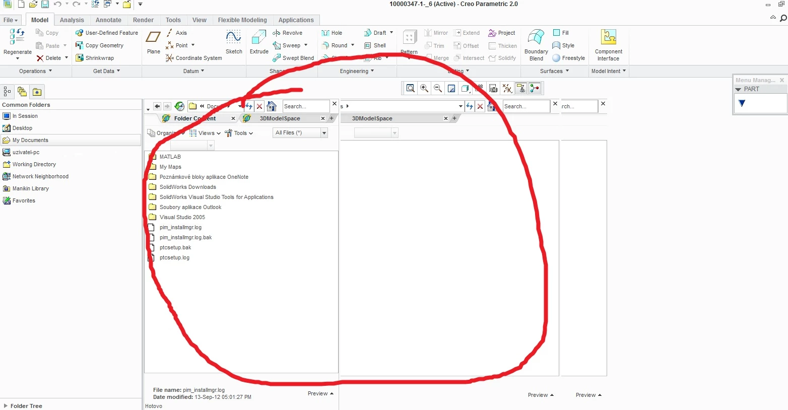

I have a problem with the area on which the model shows (CREO 2). It is still covered with explorer (see picture). I can move with explorer, but the model is not visible.
I have Intel HD Graphics 3000 (HP Pavilion G7-1151eb).
Can I ask for help? Thanks a lot!

    This is a graphics issue. I would suggest that you update your graphics driver and give it another try (note that new computers often come with outdated drivers).
    If updating your driver does not help, add the attached config.pro file to your "Public Documents" folder (typically C:\Users\Public\Documents). This config.pro file contains the option "graphics win32_gdi". Adding this option will make Creo bypass the graphics card and perform graphics display operations using the computer's processor. Not ideal for large assemblies but sometimes required on lower end, un-supported hardware.

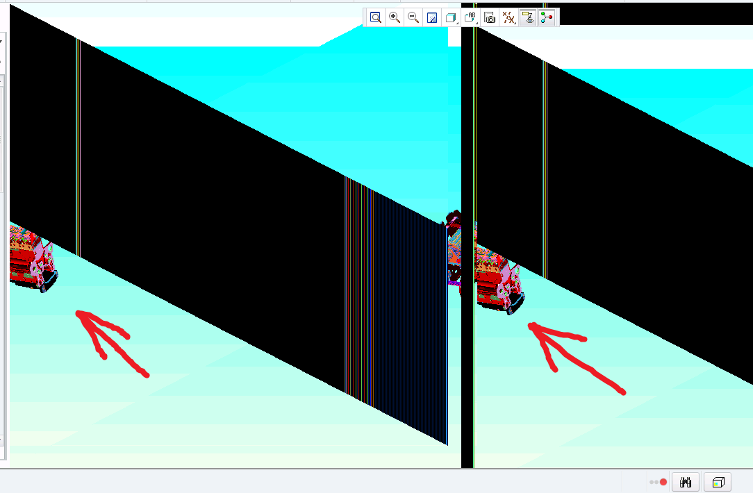

    Now, I can see a singl model, but with assembly is really problem. With your config is working too slow, It isnt useable. Without config, model is shown double times and screen turns the color of marking surfaces.
    Creo is practically useless for me but I do not work without it.creo double.png

    Jan,
    Sorry you're having problems. Did you upgrade your graphics driver? What type of graphics card do you have?
    Another thing that has helped before is to not use the config.pro (remove it) and instead, change your display from 32bit down to 16bit. This is not a sure thing but something I might try as a last resort.
