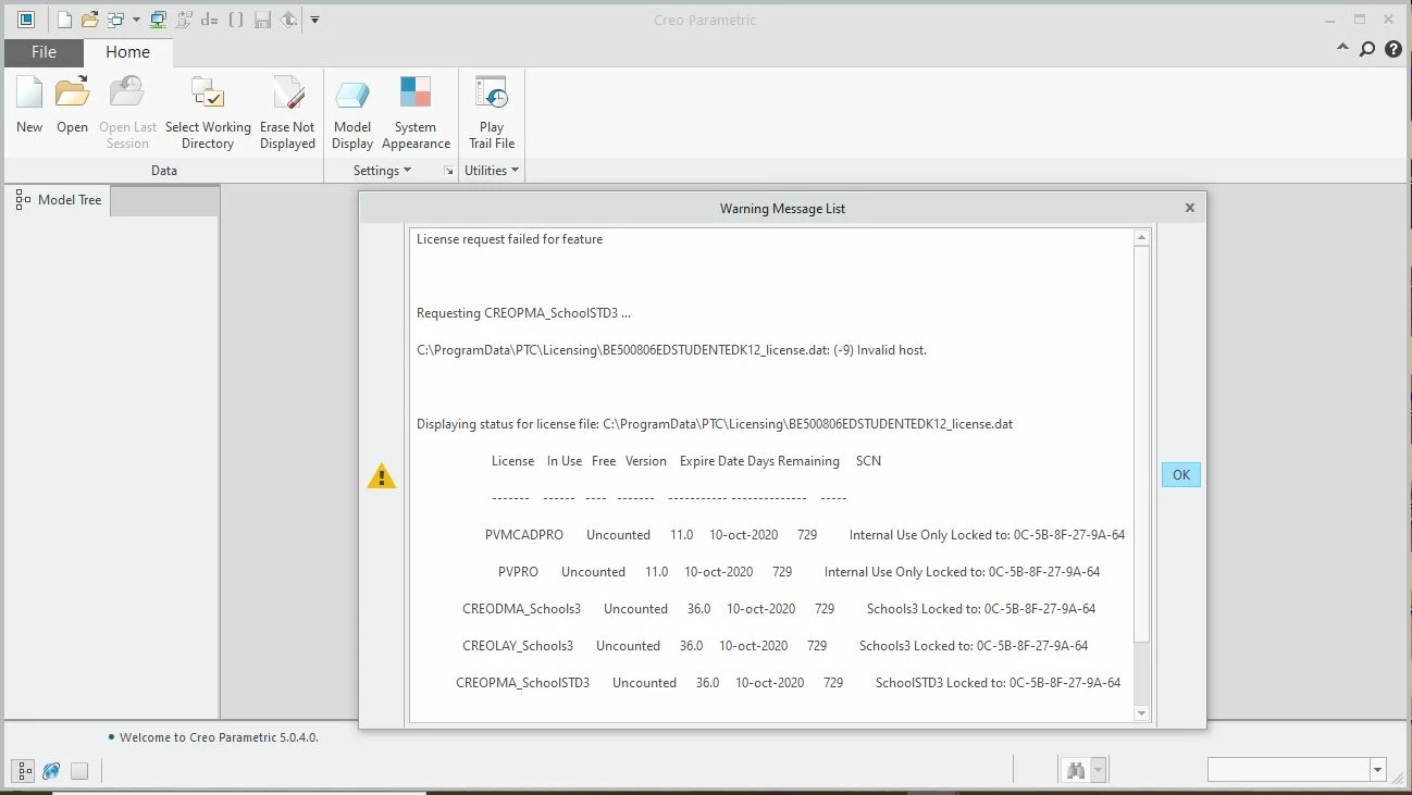

i logged on CREO parametric and i recived a email from schools@ptc.com with PTC license pack as attached.
I setuped setup-school.exe and i downloaded PTC applications but i couldn’t log-in in this step.
when i run CREOparametric 5.0 an error message appears, please find attached. Could you please help me? Thank you.

The license is valid for Creo 5.0 and should run properly.
The reason you see that error is that the Mac Address that was active during installation process is no longer available.
You can try to change the state of the Wireless (try opening Creo with WiFi on, even if it is not connected to any network). If the wireless was used (or any external USB network device) during the licensing process, it will need to stay on for Creo to work.

  • open Command Prompt window
  • run  ipconfig  /all  > ip.txt  command
  • open ip.txt in Notepad and search MAC address 0C-5B-8F-27-9A-64 shown on picture
  • if MAC address is not available then network card is not visible

ipconfig  /all  > ip.tx command doesn't work.
ipconfig  /all runs but there is not 0C-5B-8F-27-9A-64
in ip.txt there is not 0C-5B-8F-27-9A-64

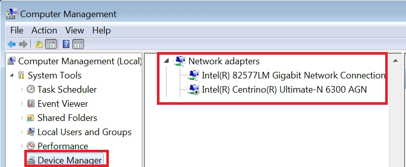

1.] open Computer Management window and check physical network card's status. All your network cards must be enabled.
On my PC, 1st card (Ethernet, wired) is enabled, 2nd card (WiFi) is disabled (see small down-arrow in circle)
2.] open Command prompt as Administrator and run following commands
netsh interface ipv4 set global dhcpmediasense=disabled
netsh interface ipv6 set global dhcpmediasense=disabled
3.] restart PC
4.] run ipconfig /all > ip.txt command, again check its contents (also you can upload the file, I can check its contents, too).
