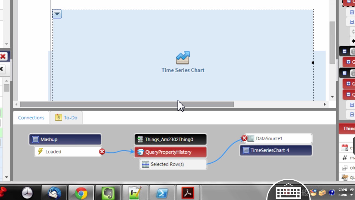

I'm new thingwork academic user.
I have trouble with displaying multi datasorce.
When I uncheck single datasorce checkbox, timeseriese graph display noting.
There is no error log about it.
http://univoftokyo.cloud.thingworx.com/Thingworx/Runtime/index.html#mashup=Am2302_new&__fromBuilder=f75f95e8-f538-40ed-8…
Would you like advise to me?
About Edge server program:
I changed the sample program, temperature-thing with rpi as follows.
I want to test scalability, so I increase the same thing to 100.
But I think there is no polling miss on rpi, because I run the program simulation mode.
I checked things get simulation value.

Best answer by ryukorin
I solve the problem.
selected Row -> All Data.
August 20, 2015
Did you bind Data to each of the individual DataSource Properties of the Chart?
And do you have a trigger that is running the service to retrieve the data?

Thank you for your help.As this photo,Binding is apropriate,maybe.
Could you have anything else idea?
