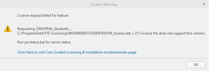

How do I get my software to support my School licensing for Creo 6.0
This is the window that keeps on popping up. I have tried to reconfigure the software and still no luck. Please, if you have any idea reply or message me.

before you run reconfigure you have to delete invalid license file saved in C:\ProgramData\PTC\Licensing directory.
If product code BK600908EDSTUDENTEDUNI will not work then use following procedure.
