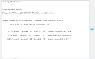

I installed the student version of Creo 4.0 on my laptop and it runs fine as long as I have an internet connection, but if get this warning when I don't have an internet connection.
I have limited access to the internet, so I would like to run it offline.
Thanks for any help you can give me.
when internet connection is ON, network card with MAC address 00-26-82-CE-F2-90 is enabled.
When internet connection is OFF, network card with MAC address 00-26-82-CE-F2-90 is disabled.
Open Command prompt window and launch ipconfig /all > ip.txt command in both situations and compare these files. I can check files if you can upload them.

@ptc-5167117 wrote:
Here are the files you requested.
Thanks again for your help.
in ip_online.txt I can see that MAC address 00-26-82-CE-F2-90 is assigned to Broadcom 4313GN 802.11b/g/n 1x1 Wi-Fi Adapter. Unfortunately I do not understand why it is not visible in ip_offine.txt.
Is Broadcom 4313GN internal or external adapter ?
Is Broadcom 4313GN disabled ?
