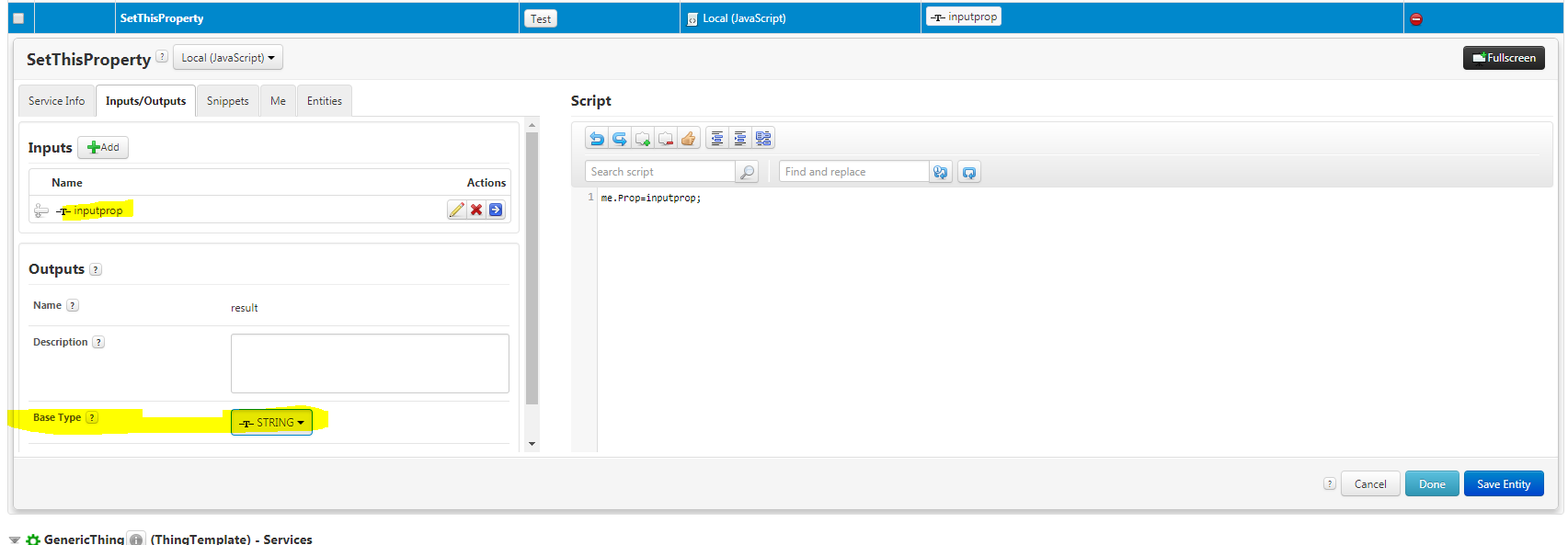

Yes, that is a wrong kind of data 🙂 From what I'm seeing, you have a service that sets parameters, meaning you feed property values to it rather than take them from the service. So you supply temperature and humidity but it does not display anything back. The opposite service would be getData. Then you would be able to consume property values from the service.
Alternatively, you may modify/edit your existing "set" service to include an output/result of a matching base type (string in this case), and then you would be able to see data that can be taken from the service, like in an example below:

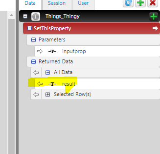

Can you please send a screenshot of your right-hand side panel where the service and "properties" are? I suspect you are dragging the properties from under the "parameters" section instead of "all results"/"selected row".

Looks like the problem with the type of data, or with type of service, but I can't realize what exactly... )
