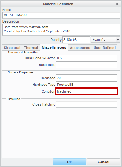

    However, after selecting METAL_BRASS and then clicking OK in the Material Definition dialog, I get an error dialog with the message "Parameter PTC_CONDITION is not defined. The material is invalid."
    Sep 20, 2013 2:07 PM UTC
    You will only see that message if you have opened the properties of the material (to edit). If you are simply assigning the material, you will not.
    The message is referencing the empty Surface Condition parameter seen here in the Miscellaneous tab. To fix the warning message, you can simply add text that describes the surface condition in the text box and save the material.
