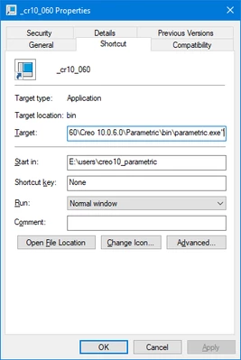

maybe my suggestion was wrong. In my psf files I use following line
ENV=PRO_LANG=usascii
Q: How are you launching Creo? Do you double-click shortcut related to parametric.exe  (see picture) ?
