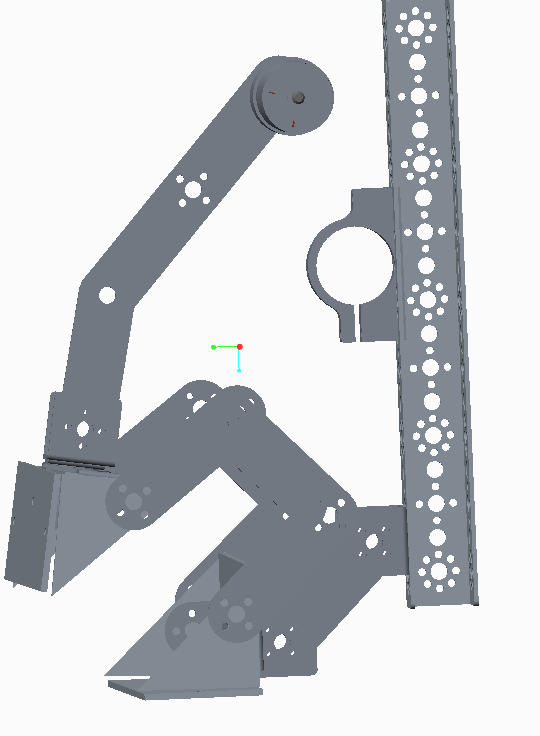

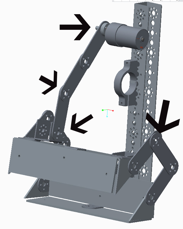

We created this claw, and have pin joints between in the following areas. Everything looks like it will work perfectly, I just cannot figure out how to connect the motor back to the motor housing, since I've already constrained it to the arm. Is there a different way to constrain the pieces so they will form a complete loop?

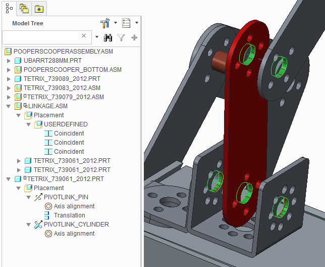

    For anyone else following this thread, Ryan shared his models with me and we found the few issues that were preventing the model from connecting as a mechanism.
    In Ryan's model, there are two moving elements, the top arm of the scooper and the motor and linkage that will drive it. We took the linkage out of the top assembly, created a subassembly with the two fixed links and assembled it directly to the motor which already has a PIN connection defined in it. That gave us an assembly with two independently moving subassemblies that needed to be connected with the final link.
    The final link was created with two constraint sets; one PIN and one CYLINDER. The PIN connection is at the top and the CYLINDER connection is at the bottom. The PIN connection defines the position and motion while the CYLINDER connection is only there for motion.

    Hi Ryan,
    One of the keys to making a mechanism work properly is to assemble it like you would in real life.
    1. Would you normally connect that arm to the motor first?
    2. How does that arm really connect to the motor?
    Oct 11, 2013 1:54 PM UTC
    Ryan,
    Looking at the images, you need to assemble the motor in a fixed location first. Then connect all the moving pieces second. In fact, if you already have pin joints where all the arrows are, you just need to put the motor in the motor clamp and you should be good-to-go. I'm guessing you may have assembled the motor to the linkage? in that case, remove the contstraint set, create a new one to mount it in the clamp and then add a second constraint set to the linkage. It will need (2) constraint sets. A pin join for each connection at the ends.
