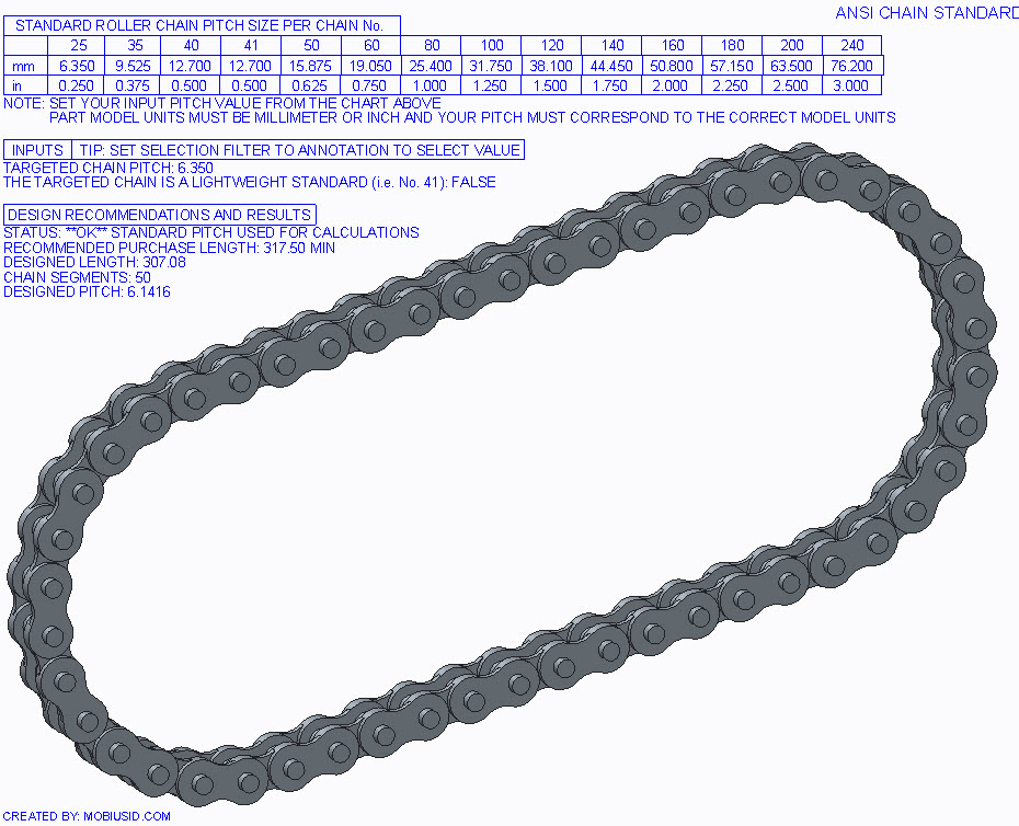

How to create a chain in Creo Parametric
Lots of people ask about how to create a chain in Creo Parametric. PTC has been providing a User Defined Feature (UDF) to create a chain in the FTC KOP for some time, but apparently we never gave enough information on how to use it. The design was created by Mobius Innovation and Development and is available on their website with PDF instructions on how to use it. It includes a great video showing how to add it to both Metric and Inch models.
Once created, the chain is a complex model, so don't worry about adding it too early in the design process or use a Simplified Representation to exclude it from your working model.
http://www.mobiusid.com/free-downloads/

This is interesting enough to cross-post into the regular Creo Modeling section.
It is an interesting example of including screen annotation with the UDF.

It works well for the 9.525 chain but I have an 8MM chain.
How do I modify a UDF to allow me to change the links?
