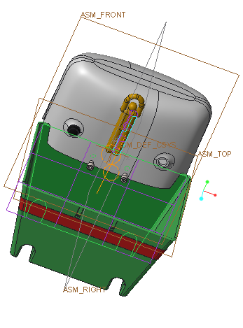

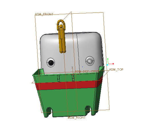

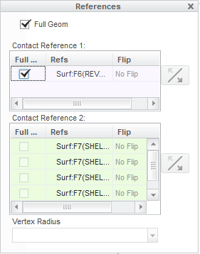

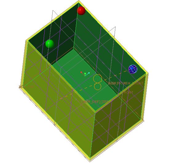

In my mechanism below I want to simulate the bouncing shown in example provided in the exercise eleven of the How to Model Anything. The yellow man consistently goes straight through the green box. I think that it is due to the fact that I do not have all the surfaces referenced as is done in the 4th picture. How do i do multiple 3D connection references, as I only have one surface 3D connection reference

    Thank you so much for your help! I understand that I should create a 3D connection for each wall of the box, but Creo is only letting me create one 3D connection. When I try to click on another wall to create another It just edits the original 3D connection.
    Could you describe the steps involved in how to add multiple 3d connections?
