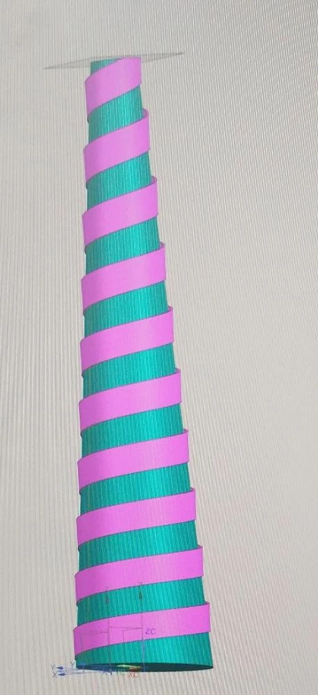

Please guide me on this topic. I didn't see any relevant example available on the internet. I have attached the model of the antenna I'm trying to create here. Please help.
I have attached Solidworks drawing I did earlier and the helix antenna pic I'm trying to create. I give up on Solidworks and now trying Creo instead. Solidworks is only halfway complete.

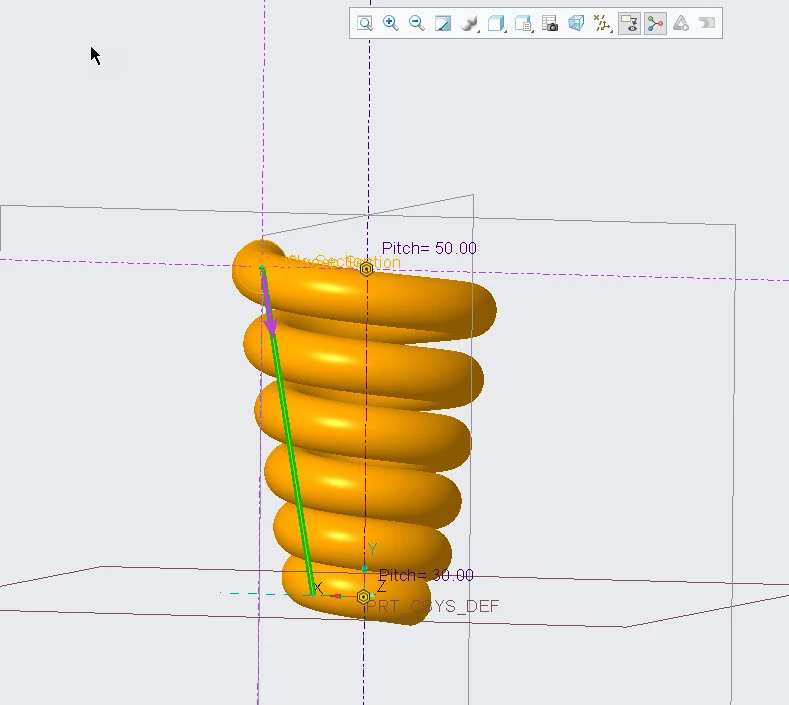

February 28, 2020
When in the first sketch of the helical sweep, if the line you use to define the helix is not vertical, the helix will follow it. So all you need to do is use the projection of the cone as the helix definition line and the cone axis as the rotation of the helix.
Alex
pragash1-VisitorAuthor
February 28, 2020
Hi, Alex,
Thanks for the reply. It's not what exactly I was looking for. Please look at the picture below. I have uploaded the same image in the .rar file I uploaded before. I want to create a planar helix antenna on a cone as shown below. please help.
