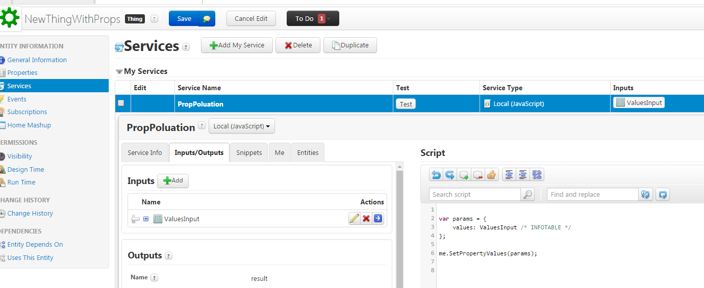

You have to have a datashape assigned to your infotable input for the values. In the following example, I already have a thing created with a couple of properties. I ran the service "GetPropertyValues" and created the datashape from the executed result. Then I created a service to populate the values, with the infotable input assigned to the datashape.
So in your case, you need to first define new properties on the thing you created via your script (by using AddPropertyDefinition), then create a datashape before populating the properties.
