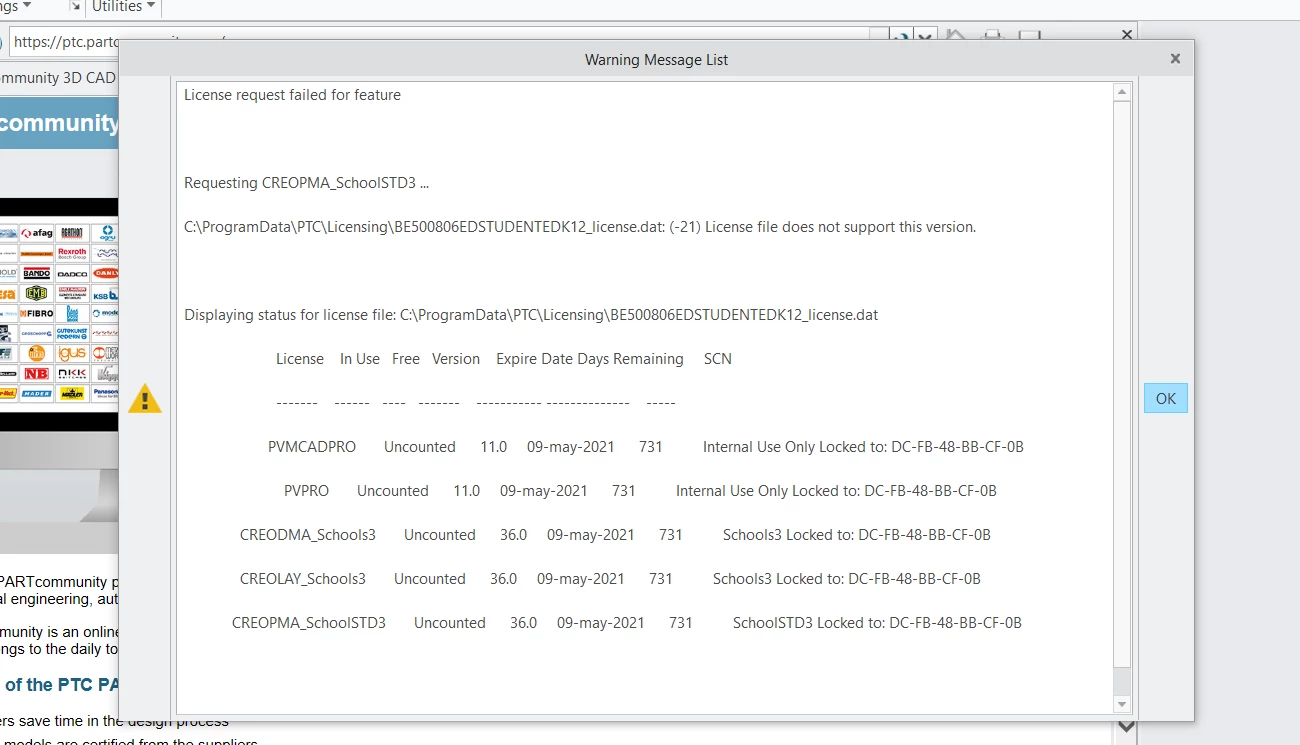

I am having a problem running creo 6.0
I applied for a student account and installed the program correctly. every time i try to run the program i get an error message saying license request failed for feature(see attached). I need this program for my class please help. thank you.

license file mentioned on the picture contains Creo 5.0 license (see version 36.0). I guess you installed Creo 5.0 in the past.
You have to empty C:\ProgramData\PTC\Licensing directory before starting Creo 6.0 installation !
Please read following documents:
https://apps.ptc.com/schools/references/install_creo6_unistudent_standard.pdf
https://apps.ptc.com/schools/references/install_creo6_schools_standard.pdf

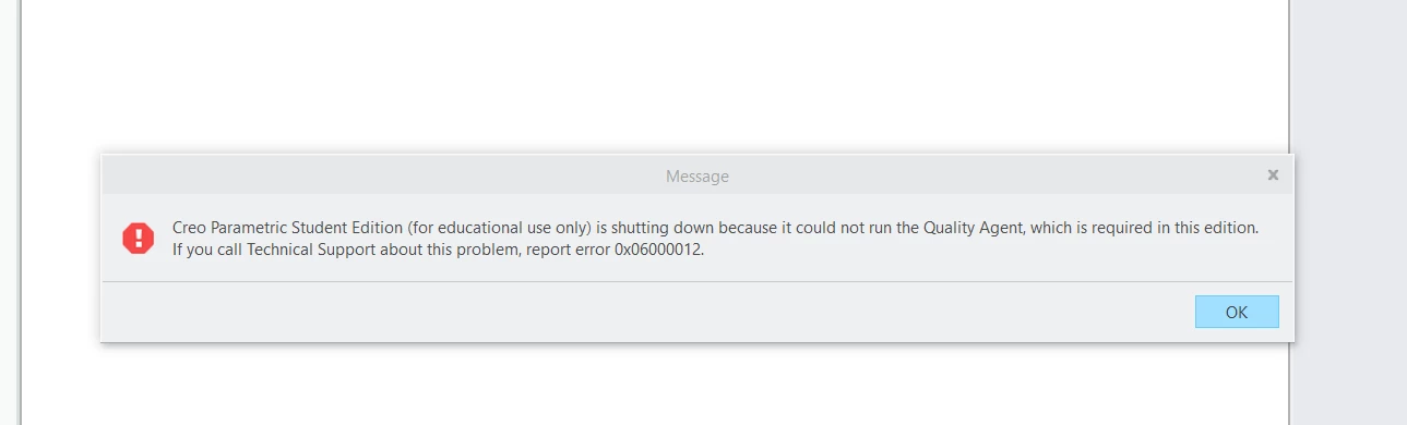

when i go into the program files all i have in the ptc folder is common files, install manager, parametric, and simulate. where should i go from here.

I tried reinstalling the program and i am now getting this message when running
