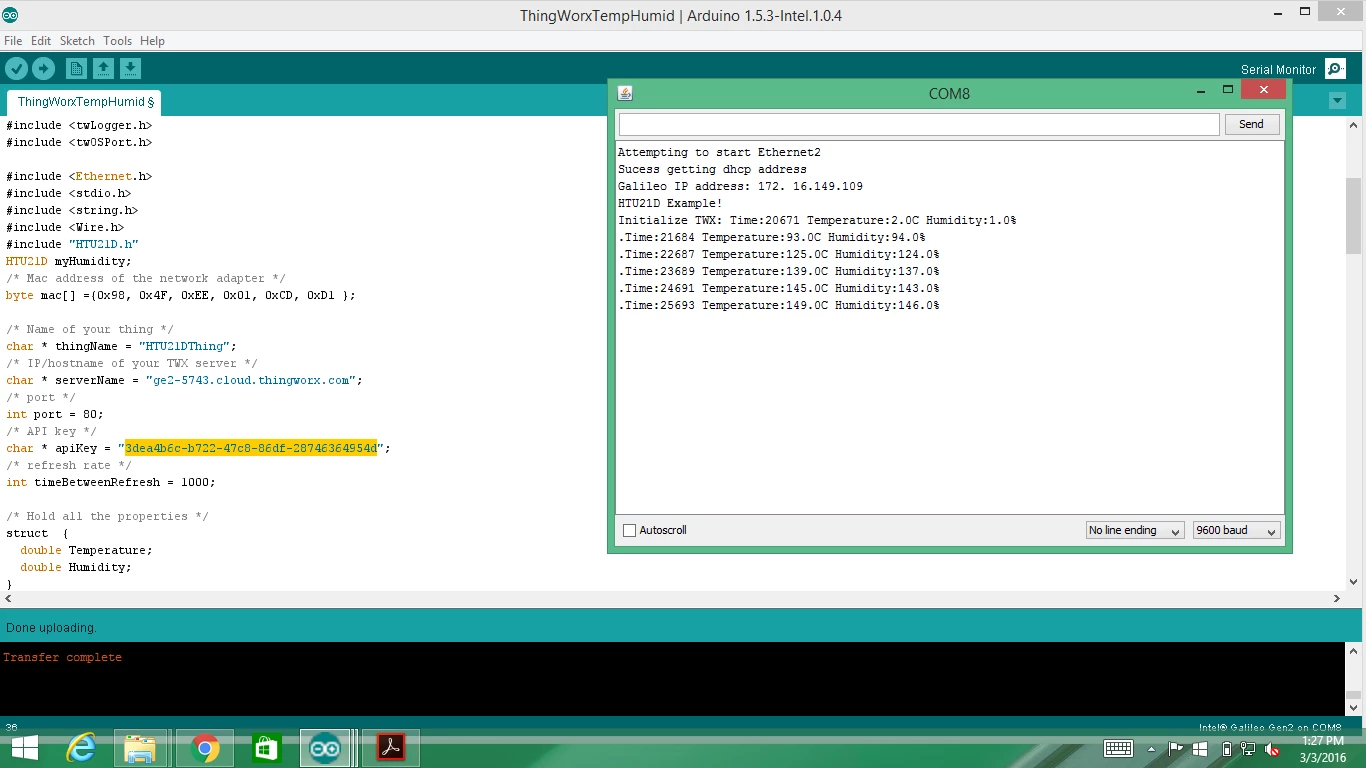

​I am doing project on Intel Galileo and using C SDK. I am trying to do weather app. But i am unable to send my data to cloud . I try to manage binding but it gives error as "Error browsing properties. Be sure the remote device/server is connected and configured properly".
I am using TWX agent and i dont know is it working or not ? Posting photos of serial monitor .

It seems that the ThingWorx API has not properly established the connection... How have you connected your Intel Galileo to the internet ? Is your network using a proxy ? This might cause the connection to ThingWorx to fail.

I am using ethernet cable from router to connect Galileo to internet . I dont know about proxy network .

I had this issue, the C Edge SDK not connecting to ThingWorx  in my office network because websocket requests were blocked.
Please check the answer to this post and see if it solves your problem.

In the modeled RemoteThing in the Thingworx platform, do you see isConnected as being True?
Next you would have to check and see if you declared the properties properly in the Agent so that you can browse them.
When you look at your debug or console for the Agent, does it seem to say that it is sending Property Values?

I do not see anything when i try to bind remote thing . It gives error .

Is there a specific error message? As Pai stated, is the isConnected property set to True under your Remote Thing's properties? When you run the sim, do you see any Remote Things show up in the unbound tab?

If you are sure that the university uses a proxy server the C SDK does support connecting through a proxy. You need to get the host and port of the proxy server (and if the proxy server requires you to use a username/password). Before you connect (but after you call twApi_Initialize) you need to call
int twApi_SetProxyInfo(char * proxyHost, uint16_t proxyPort, char * proxyUser, char * proxyPass);
The SteamSensor examples have this code in there, except that the line to add the proxy info is commented out.
