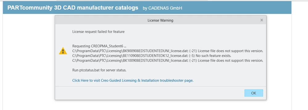

I am using the creo student version & facing this issue "License request failed for feature"

I'mcreo license failure.png a student trying to use the creo student version and I'm facing this issue

open BE110908EDSTUDENTEDK12_license.dat in Notepad and find correct license name. I hope it starts with CREOPMA string.
Then open parametric.psf located in Creo 11.0 installation and replace CREOPMA_Student6 string with correct license name.
