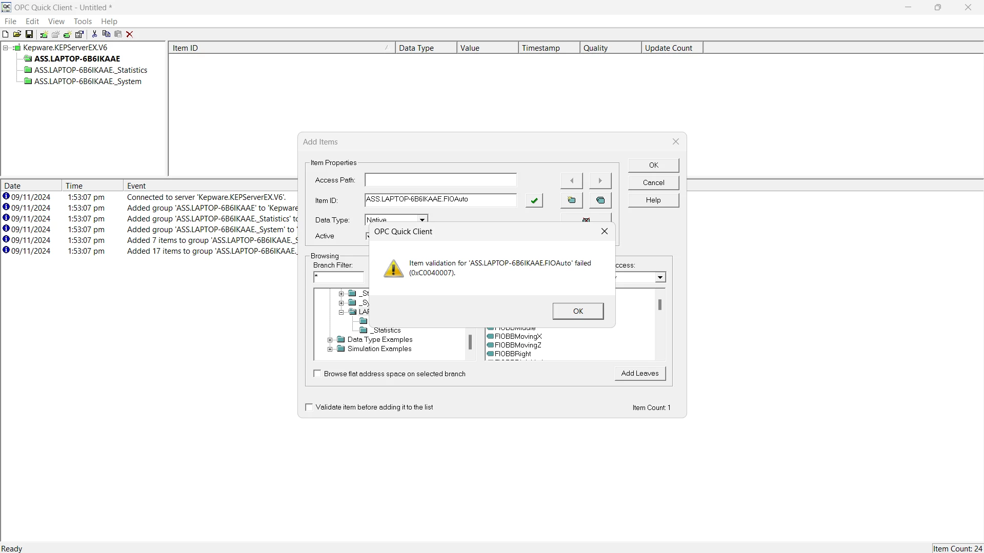

I can't access tags in KEPServer EX 6 Quick Client Window

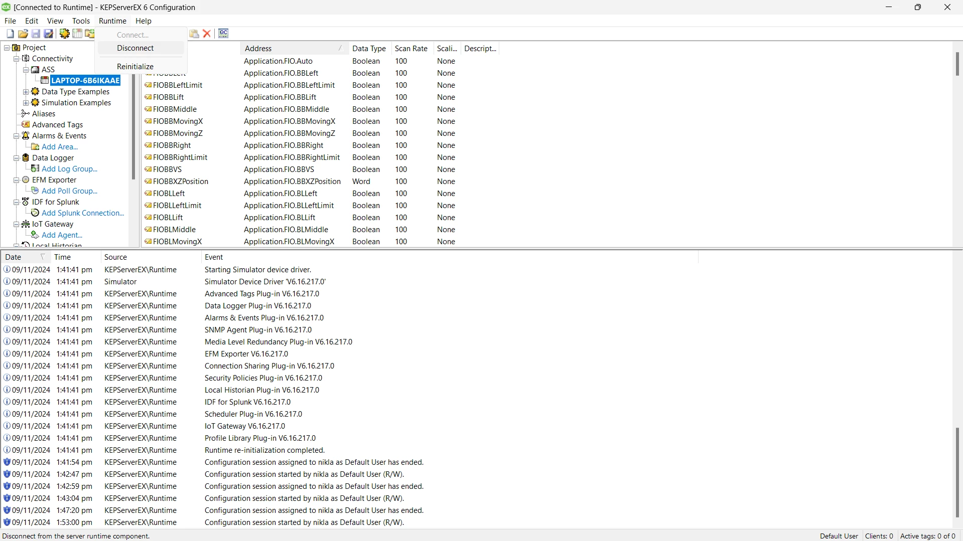

No tags show up and it comes up as empty and when i try to manually place tags it says item validation failed. I have tried disconnecting and connecting the runtime since I am using the trial version but that does not seem to help. I am trying to connect it to CODESYS and then to Factory IO. Any help would be greatly appreciated.
VladimirNAnswer
November 10, 2024
About error code 0xC0040007: https://www.ptc.com/en/support/article/CS281761
