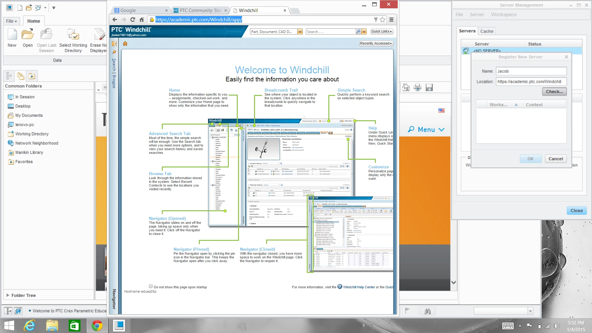

I can't log into my Windchill server while on Creo Parametric 3.0
I can still log onto Windchill while on a browser like Google Chrome or Internet Explorer but I can't register my robotic's team server. I have tried restarting my computer, repairing Creo 3.0, deleting Creo 3.0 and reinstalling it and nothing is working. The error is "invalid server location. Please change the "location" field and try again."
    January 6, 2015
    I ended up getting it to work. The solution was to go into cache, copy it and paste it into the search on my computer. I then found a folder with the server address amd deleted it. Then I restarted Creo and it worked.

    The only thing I have seen similar to this issue, is when connecting to Fresno Unified's secured wireless network.
    Have you tried registering your server from home or any place besides school?
    Has anybody besides you used the PC, or do you have multiple logins?

    I have tried connecting to different wireless networks and I have the same problems. I am the only one who uses my computer so I don't have multiple logins.
    January 6, 2015
    So you deleted C:\Users\<username>\AppData\Roaming\PTC ?
