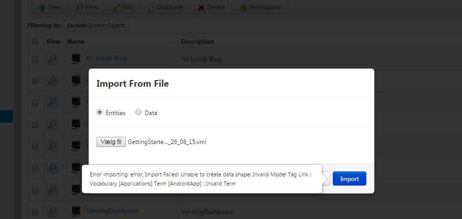

I have started the ThingWorks prepared exercises, Instruction about an Android Mashup. The installation on Android Phone went fine, but the Import of the MashUp fails. The file name downloaded is not the same as written in the PDF-Guide: TWXAndroidAp

Hello Mr. Professor,
I have seen the image with the error you are receiving :

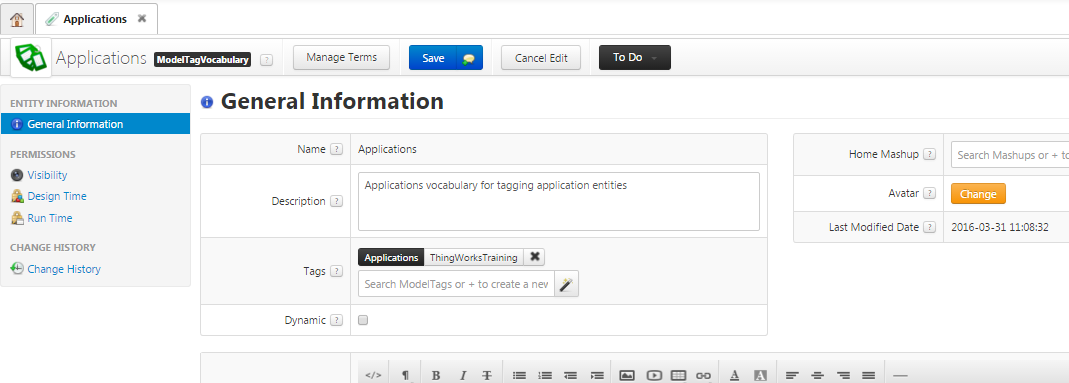

Please create a Model Tag named AndroidApp in the Applications Vocabulary.
To do this search for the Applications Vocabulary in the SearchSpotlight, open it in edit mode and then click add manage terms:
Add a new term called AndroidApp. This should fix the error you are seeing when importing the file. Please import again and let me know if the problem was fixed.
There is indeed a mismatch between the name of the file in the pdf instructions and the actual xml file in the archive. Thank you for pointing that out. We will have it updated. But the xml document to import is the correct one.
Thank you,
Veronica

Yes, this helps, I got the MashUp running, but I had to follow the procedure to create two missing tags.
