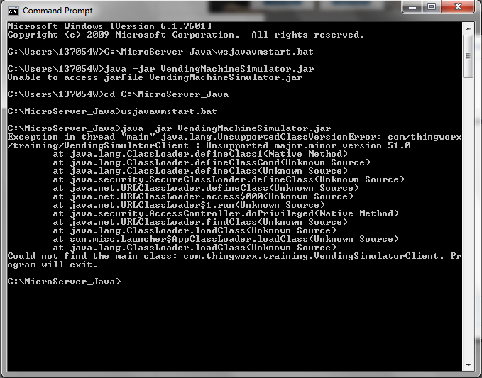

I need help .. I having this problem that it kept saying that they cant locate my Vending Machine simulator. I downloaded from the Academic Program. error.png

This error is due to a mismatch between the java version with which the jar was compiled and the java version you are using the run the jar file. Please update your java version and try running the jar again,
