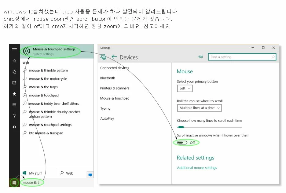

If Scroll No Zoom, In windows10 (creo 2.0,3.0)
  • August 25, 2015
  • 0 replies
  • 908 views
follow enclosed picture
(mouse setting )
