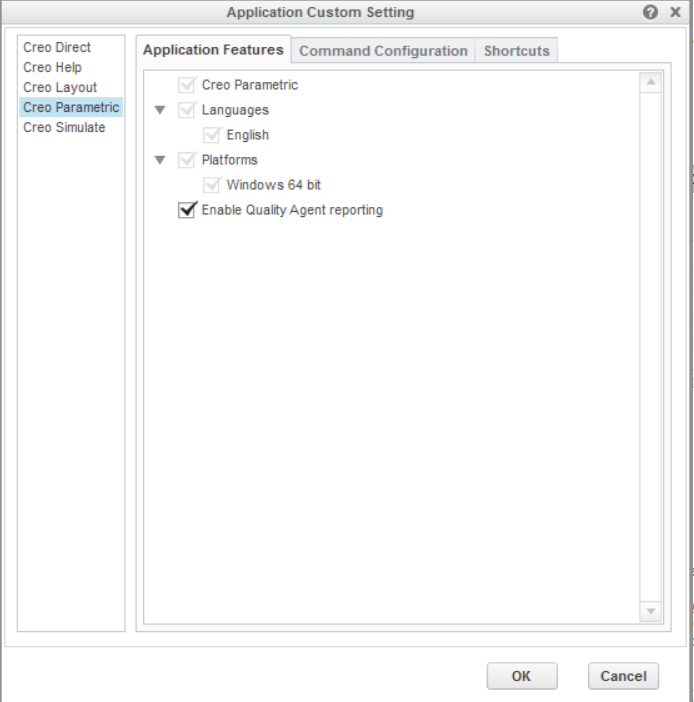

    Hi Martin,
    I'm asking about Creo 2.0 Student Edition. Unfortunately I do not get such kind of options during the install process:
    So obviously the short answer is - No!
    Mar 13, 2017 11:44 AM UTC
    how did you get the picture ?
    Did you launch setup.exe and install new Creo installation ?
    -OR-
    Did you launch reconfigure.exe ?
