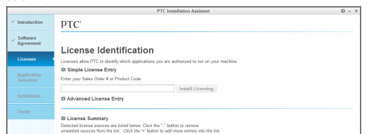

Im installing creo 3 student edition
  • September 12, 2016
  • 7 replies
  • 3945 views
Simple License Entry is greyed out and wont allow me to input the license. please assist

    please read Creo 3.0 student edition license expired, Product code Re-Licensing doesn't work
    K-12 students can use Product code BE400407EDSTUDENTEDK12
    University students can use Product code BK400407EDSTUDENTUNICL

    I tried that as well still nothing happens
    September 13, 2016
    please describe exactly what did you try. Add additional screenshots reporting error messages.
    Are you logged as Administrator ?
    Do you have Internet Access ?
    Do you have PTC account created ?
    Where did you get installation media ?
    What is the size of installation media ?
    What setup*.exe files are present on installation media ?
