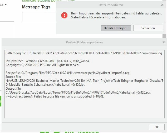

I already designed a 3D model of my machine in Autodesk Inventor 2020.
There are problems with importing both of  the autodesk inventor files (.ipt and .iam) into Creo Illustrate Professional 6.0.
I attached the error log from Creo.
Maybe someone can help me with my problem.

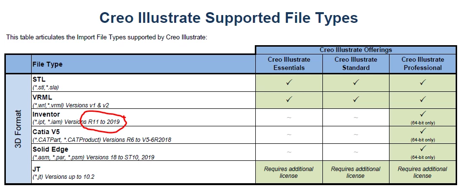

I guess that the answer is very simple ... in Creo Illustrate 6.0 the ability to open Autodesk Inventor 2020 file is not yet implemented. Usually it takes several months to implement the ability to read new file format.
On https://www.ptc.com/en/support/refdoc/compatibility/technicalgraphicscompendium_168055 page there is a link to PDF file containing Technical Graphics Compendium. On page 7 I can see this

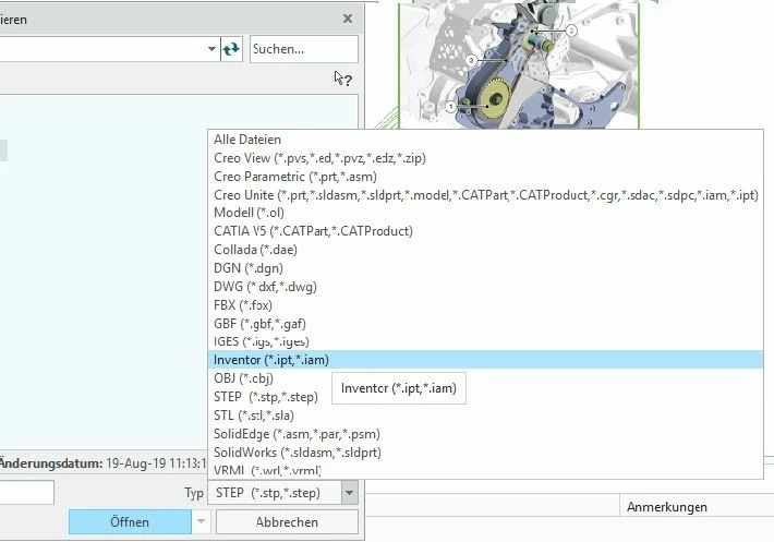

I saw youtube tutorials, where Autodesk Inventor files were linked directly in Creo Illustrate.
The advantage is that i can change my 3D model in Inventor and i have directly the updated
model in Creo Illustrate.
Do you have another solution for my problem?
I mean there is the option to directly import Autodesk Inventor.

Ohh that's too bad. This should be the problem. Unfortunately i  looked over it.
I guess i have to try to get an older version of Inventor and try to import my model there first.
