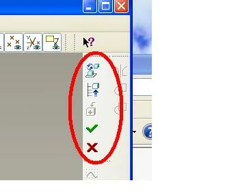

Import Data Doctor not working
Using Wildfire 4.0 M092 Student Edition 4 I've imported shared data and carry out EDIT DEFINITION the system goes into the command but the 'Import Data Doctor' ICON is low lighted and I cannot do any thing. Is there something I should be turning on first.

    Paul, Unfortunately, the Data Doctor functionality is not included in the Pro/ENGINEER Student Edition. That is the reason the button is grayed out. The only options available without Data Doctor are to Reload and Collapse Geometry. Also, clicking Edit> Feature Properties, will open the Properties dialog box you use "Make Solid" to make a closed quilt into a solid. I'm sorry I don't have a better answer for you. Sincerely, Adam Haas PTC Education Programs
