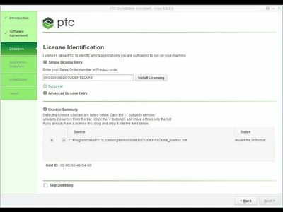

I'm trying to install the creo 6.0.2.0 but always getting the problem in install licensing.
It showing invalid file or format instead of available.
Tell me what i have to do now
I attached a picture of that where I'm getting problem plz help me to solve this issue.

please zip and upload your license file.
Also run ipconfig /all > ip.txt command from Command promt window and zip and upload ip.txt file.
I guess that the problem is related to network cards.

Hi. I have absolutely same issue. could you please help me with this.
September 16, 2021
your C:\ProgramData\PTC\Licensing\BK600908EDSTUDENTEDUNI_license.dat file does not contain license code, unfortunately I do not know why. Maybe @Alex_Cazacu can help to resolve your problem.

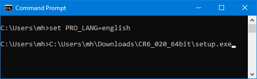

Sometimes some PTC routines have problem with non-english environment. Therefore you can:
  1. remove all files from C:\ProgramData\PTC\Licensing directory (I suggest moving them in other directory)
  2. launch installation in English ... see following example
