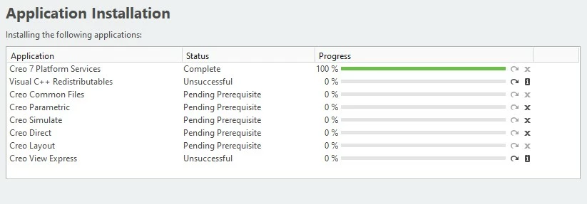

i am not able to install creo parametric through installation assistant

Article - "PTC installation assistant displays message "Pending Prerequisite" under the status during installation of Creo Parametric": https://www.ptc.com/en/support/article/CS283411
August 6, 2023
you can try installing Visual C++ Redistributables manually.
Installation files are located in ptcsh0 sub-directory (unzipped installation package).
