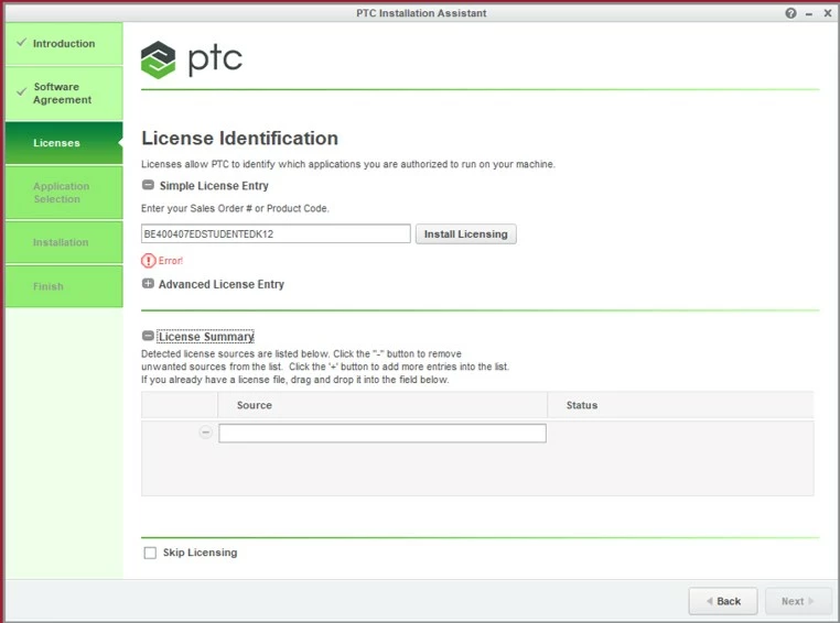

Hi Guys.
Good evening.. i need your help.. well basically, teacher want to me to install Creo 3.0 from MED-100WIN-CD-400_M190_Win64 onto all student machines.
Now i have read all the instruction on how to install Creo 3.0, when it comes to section where i have Run - setup-schools.exe and i have right click the file and select " Run as Administrator" - Successfully done
then i click install new software then click Next - Successfully
then i accept the licence agreement then click Next - Successfully
then i cannot see any list of Creo programs in the box as its all white box.
What can i do to get to see list of Creo Programs which i can install or not etc.
Please advice me please.
Look forward to hear from you soon.. Thank you
Kind Regards
Bhav

  • unzip MED-100WIN-CD-400_M190_Win64.zip
  • run setup.exe
  • use BK400407EDSTUDENTUNICL (university student) or BE400407EDSTUDENTEDK12 (K12 student) as Product code

Hi Martin
Thanks for Licence for K-12, as i try to enter the key and its gives me error message
i have tried to run as Administrator, still given me error message.
Please advice what next step shall i do ..

as you can see in https://community.ptc.com/t5/PTC-Academic-Program-Discussions/Start-up-license/td-p/237246 discussion, product codes worked well in 2017. Unfortunately I do not know why they do not work today.
Possible cause no. 1.]
Installer cannot find suitable network card. Please run ipconfig /all > ip.txt command in Command Prompt window and upload ip.txt.
Possible cause no. 2.]
Product code BE400407EDSTUDENTEDK12 does not work anymore. You can install Creo 7.0 to get license file and then install Creo 3.0 using this license file.
Creo 7.0 Student edition: BK700908EDSTUDENTEDUNI
Creo 7.0 Schools edition: BE700908EDSTUDENTEDK12
