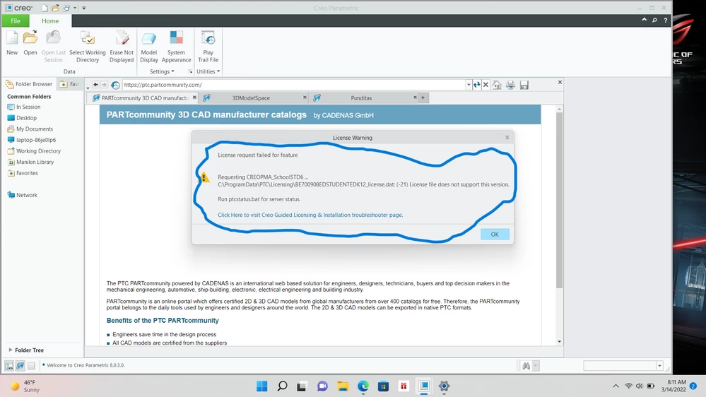

I'm a student and I was trying to install creo 8.0.3 version using the students installation guide. The license that was in the guide got rejected. I don't know what to do next. Could someone help me out?

product code BE700908EDSTUDENTEDK12 is intended for Creo 7.0.
When installing Creo 8.0 you have to use product code BE800908EDSTUDENTEDK12
Important note: Before starting installation please go to C:\ProgramData\PTC\Licensing directory and move all files to different directory.

Please show a screenshot of the error that occurs.
