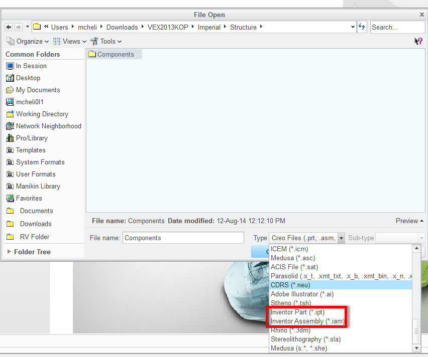

I am currently a high school student looking to get into CAD. I have spent a lot of time with Inventor but I would like to move on to better software. I mainly do stuff with VEX parts for my robotics team but I'm having issues. Is it possible to import Autodesk parts into Parametric? Here is the link to the VEX parts I use http://www.autodesk.com/education/competitions-and-events/vex/recommended-software (the 2013/2014 version near the bottom), if that helps. I know with Creo 3.0 this is possible but I'm unsure about the Student 2.0 version.

    Jake,
    Glad to hear you're intestered in Creo! You can absolutely import them into the student edition of 2.0. When you click on either Open or Assemble (if you're creating an assembly) you have the option to change the file Type that you are a looking at (see below). If you set it to Inventor Parts or Inventor Assemblies you should be able to import them.
    This will be much improved when Unit technologies comes to Creo 3.0, so keep an eye out for it!

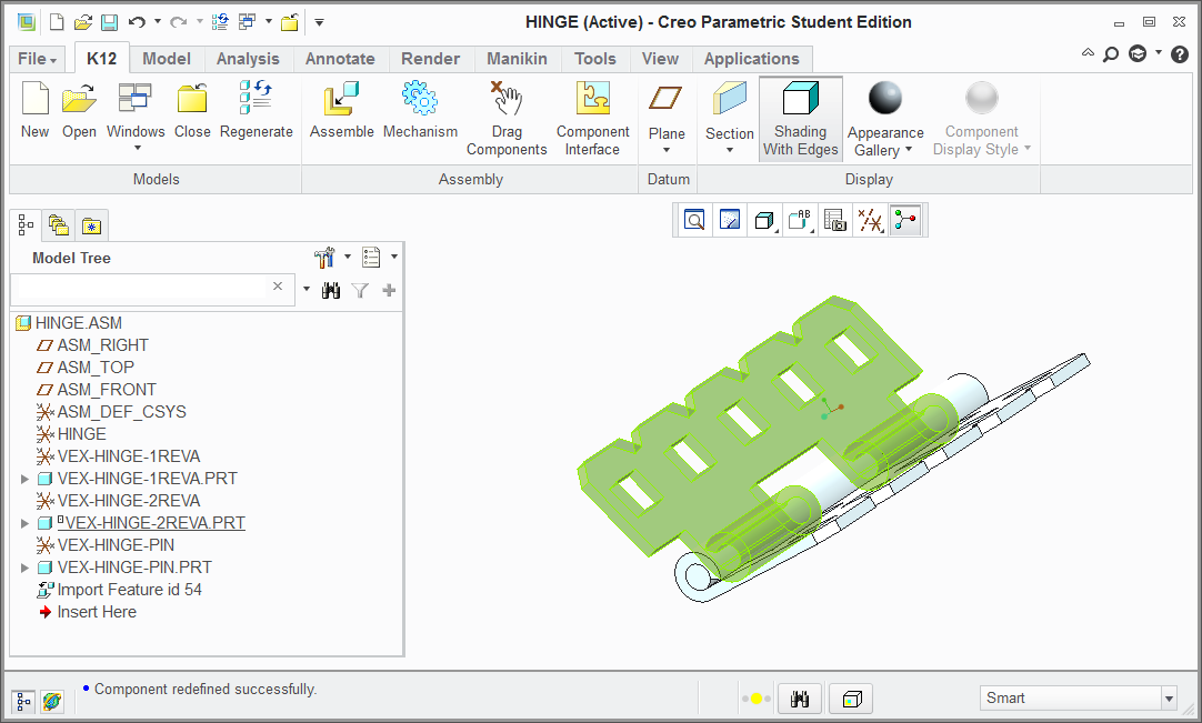

    Jake,
