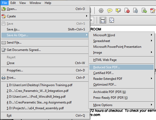

    Dec 19, 2014 9:08 PM UTC
    Paul,
    You could try printing to JPG instead of PDF as an option. PDF is not very efficient with images unless configured for it. There is also a Save As option in Adobe Acrobat to create a reduced size file. As far as I know, it is only available in Acrobat Pro, not the Reader.
