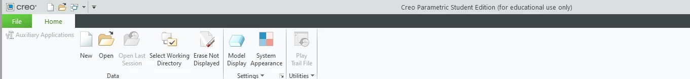

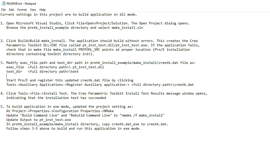

I was trying to install Creo Parametric Toolkitt following Getting Started Guide, but I get stucked. When I reach step 2.8( Running the Makefile Project), I can´t proceed to the next steps. I built make_install and modified protk_install_example/make_install/creotk.dat, but I can´t use auxiliary applications at Creo Parametric. You could check the steps I followed (until 3), and how is Auxiliary Applications locked.

Toolkit module is not included in free Student license.

Indeed Toolkit is not included in Education licenses:
https://apps.ptc.com/schools/references/Creo9_Education_Editions_Comparation_Chart.pdf
