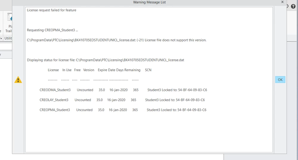

I keep getting this message when I try to use Creo Parametric 5.0 on my LaptopI keep getting this message when I try to use Creo Parametric 5.0 on my Laptop
January 17, 2019
license file mentioned on picture was generated via Creo 4.0 Product Code BK410705EDSTUDENTUNICL.
Look into C:\ProgramData\PTC\Licensing directory ... is there any other license file ?
Valid Creo 5.0 Product Codes follow ...
K-12       students can use Product code BE500806EDSTUDENTEDK12
University students can use Product code BK500806ED0790-Y3M9-4RW5
Creo 5.0 installation procedure is described in:
http://apps.ptc.com/schools/references/install_creo5_schools_standard.pdf
https://apps.ptc.com/schools/references/install_creo5_unistudent_standard.pdf
