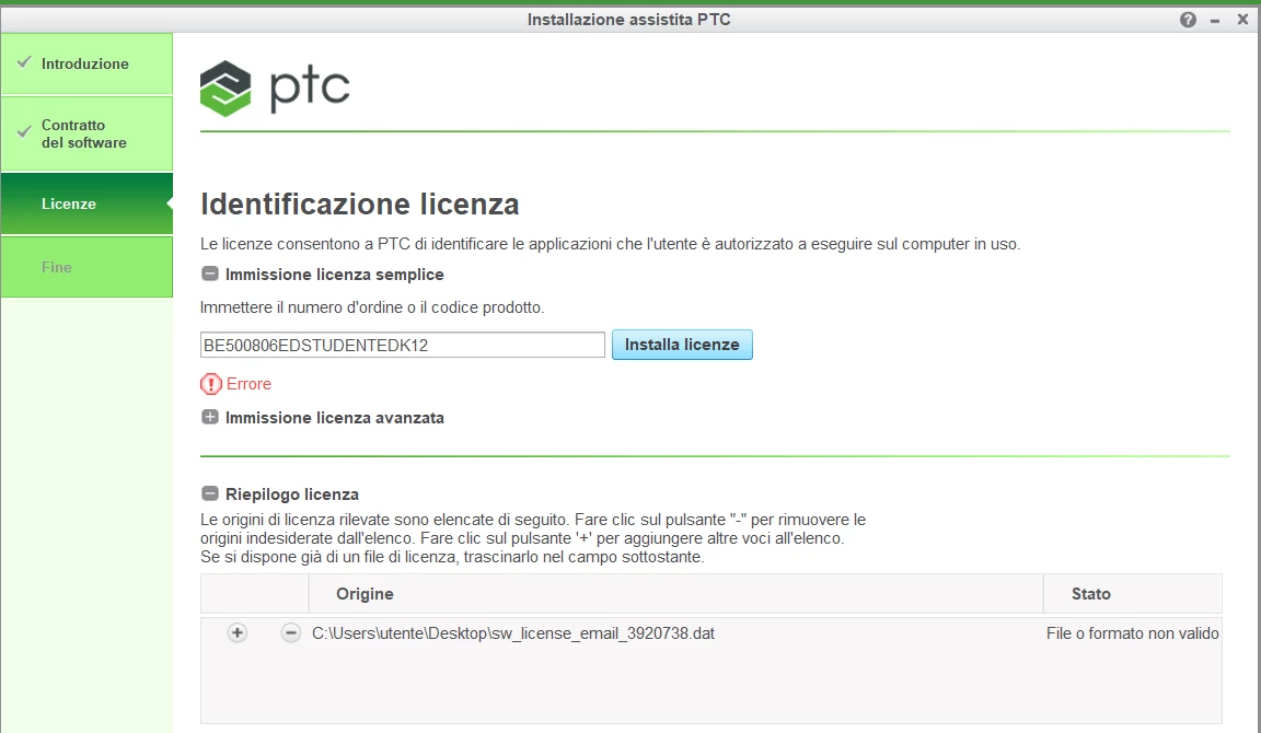

I've to install ptc creo for university. I've already used it on my pc but then when i had to reset it for other problems (not regarding PTC) i've tried to put back PTC  but it gives me a problem with the license.
The setup says 'error' when i enter BE500806EDSTUDENTEDK12  as the license key and my personal email (it's not a problem of email/password because they are the same of this forum).
I've tried to put manually the license i've got from the previous installation by email but it says ' File or format not valid'.
What can i do?
(The text in the photo is italian)

1.] contents of license file sw_license_email_3920738.dat
The file contains licenses related to network card with physical address 44-8A-5B-67-65-99.
Unfortunatelly physical address 44-8A-5B-67-65-99 is not present in ip.txt.txt file ... this means that network card with physical address 44-8A-5B-67-65-99 is not available.
2.] network card with physical address 44-8A-5B-67-65-99
ip.txt.txt file does not contain information related to Ethernet network card. I can see information related to WiFi network card (Intel(R) Dual Band Wireless-AC 8265, C0-B6-F9-B1-ED-38).
I guess, Ethernet network card is disabled on your PC. Try enabling it and check ipconfig /all > ip.txt output again.
3.] Creo Parametric license name
License file sw_license_email_3920738.dat contains Creo Parametric license named CREOPMA_SchoolSTD3, you can use the license to launch Creo Parametric up to release 5.0.
