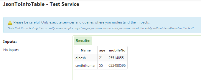

Result of the service:

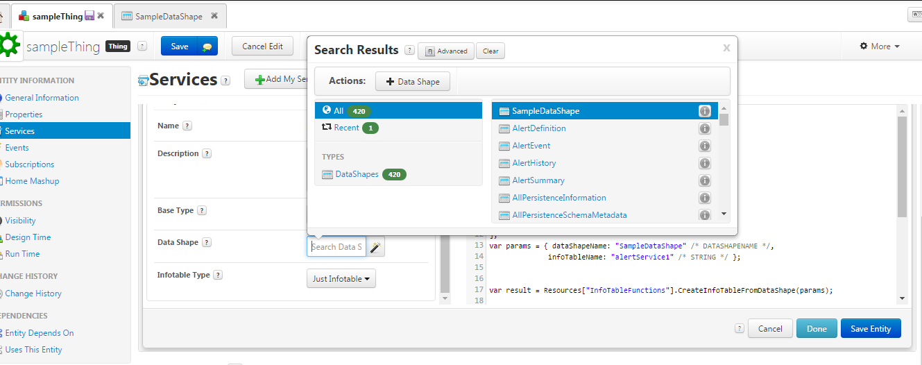

​Then  select the datashape  for Mashup Loading:
1) edit the Service(you created).
2) click input/output bar.
3) add datashape(you created)
4) check the output should be Infotable.
