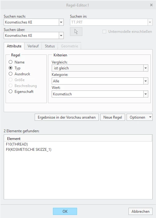

does anyone know if there is a layer tree rule to capture cosmetic sketches? The closest I get is via "look for: cosmetic feature", "look by: cosmetic feature", and then by "type: cosmetic", which captures all cosmetic features, including e. g. threads (cf. attachment). This is not exactly what I need though since I'd like to have a layer with only cosmetic sketches on it. Can this be done or is there no better way than the one I found?

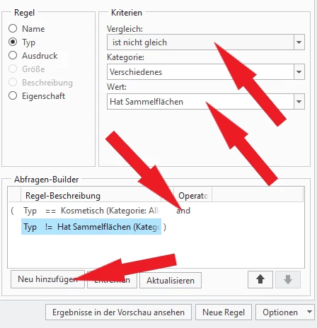

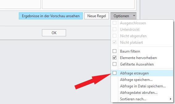

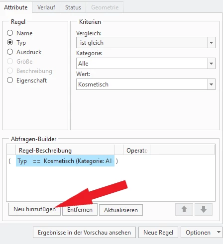

Create a rule and start the query builder. The first query is with your rules, you've already found by yourself (look for: cosmetic feature, type: cosmetic). Start another query with "look for: cosmetic feature", "type: has not quilt" and add it to the query builder. Change the logic operator to "and". That's all Smiley Wink
Take a look at the attached pictures, please.

Hello Biaglas,
thanks a lot. Just what I needed. Cheers!
