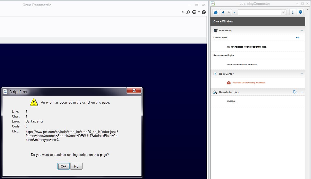

    In case some of you IT gurus can decifer the issue, this is the error that is logged in the Learning Connector:
    Thu Feb 28 22:43:04 GMT-800 2013 com.ptc.labs.connector SEVERE: Timeout while calling https://www.ptc.com/cs/help/creo_hc/creo20_hc_lc/index.jspx?format=json&search=Search&task=RESULT&defaultField=Content&mimetype=text%2Fhtml&locale=en&searchWords=Getting+Started+with+Creo+Parametric&product=Parametric&remoteUrlRoot=https%3A%2F%2Fwww.ptc.com%2Fcs%2Fhelp%2Fcreo_hc%2Fcreo20_hc_lc%2F&apiformat=jsonp
    com.google.gwt.jsonp.client.TimeoutException: Timeout while calling https://www.ptc.com/cs/help/creo_hc/creo20_hc_lc/index.jspx?format=json&search=Search&task=RESULT&defaultField=Content&mimetype=text%2Fhtml&locale=en&searchWords=Getting+Started+with+Creo+Parametric&product=Parametric&remoteUrlRoot=https%3A%2F%2Fwww.ptc.com%2Fcs%2Fhelp%2Fcreo_hc%2Fcreo20_hc_lc%2F&apiformat=jsonp

    Thanks Martin. I'm afraid that didn't fix it.

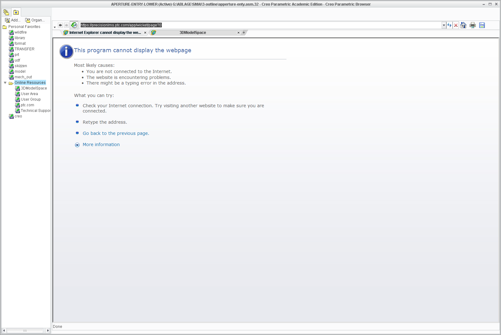

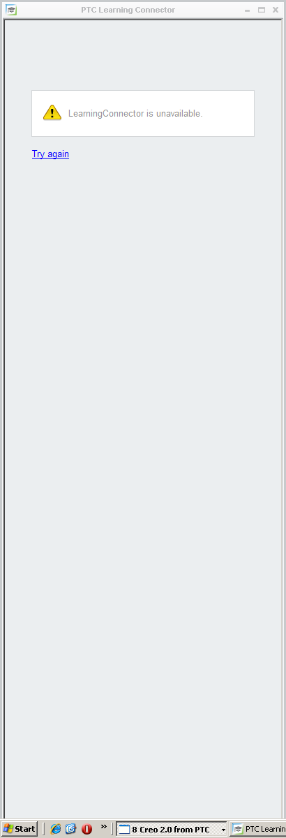

    Recently my LearningConnector stoppt working on XP64 with Creo 2.0 M110 and IE8. The error message is "LearningConnector is unavailable." and "Try again". https://precisionlms.ptc.com also does not show up in the embedded browser (IE8) but "Welcome to Learning Exchange!" works.
    Everything was fine some days ago. "Precision" is still working with other browsers running separately on the same workstation.
    Have attached screen shots. Stopped "Precision" running on IE8?

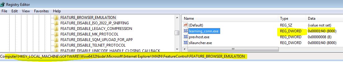

    Here at my company, IE 11 is rolled out in a way that compatibility mode per process(learning_conn.exe) is needed.
    FYI, the learning connector spawns from the creoagent.exe of which is a 32 bit app. Thus Settings for 32 bit IE are in play.
    We had to set the compatibility mode to 8 (8000)  in the registry specifically for learning_conn.exe in the LOCAL_MACHINE, 32 bit IE section.
    Here is the path and the settings:
    HKEY_LOCAL_MACHINE\SOFTWARE\Wow6432Node\Microsoft\Internet Explorer\MAIN\FeatureControl\FEATURE_BROWSER_EMULATION
    DWORD-32bit
    learning_conn.exe
    Value = 8000 Decimal
    Once this is set, Learning Connector will launch without Script errors.  You may get the TRY AGAIN though still.learning_conn_fix_IE11.JPG

    Yes, still get "LearningConnector is unavailable." and "Try again" on XP64 with Creo 2.0 M110 and IE8...

    Jan,
    Did you try Pete's suggestion. You need to elevate your rights on your computer if you are not an admin. This is a change to the computers registry.
    Use Regedit and go to the path below.
    You need to make a New, DWORD (32bit) Value
    Name it learning_conn.exe
    Change the Base to Decimal
    and change the Value to 8000
