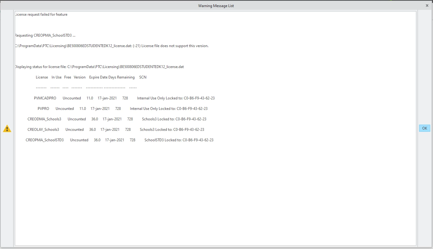

So I'm currently a student, enrolled at an engineering school, and Creo is required for one of my courses. I already have Creo 4.0 installed on my computer due to a previous class requiring it. The class I am currently taking requires Creo 6.0 which I have installed on my computer. Yet every time I open Creo 6.0 Parametric, I get this error message (Attached below).
I am just trying to do my homework from home, any help would be appreciated.
January 20, 2020
Most likely you used setup-schools.exe instead of setup.exe as the license is wrong.
Please follow he guide and use the product code:
BE600908EDSTUDENTEDK12
Select reconfigure existing software after running setup.exe and use the new code.
