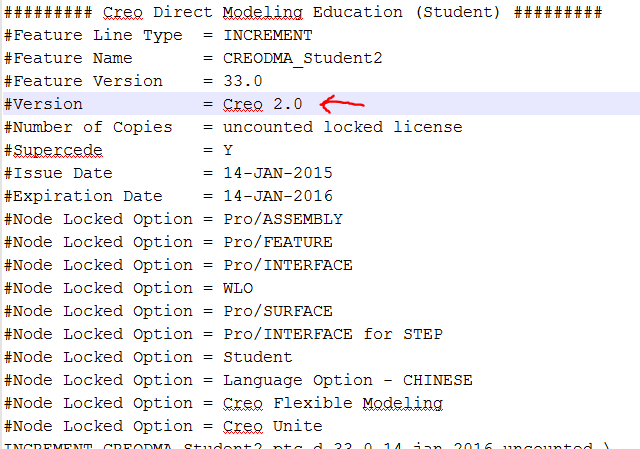

Today I installed Creo 3.0 on my PC. I followed the instructions as seen on http://apps.ptc.com/schools/references/install_creo2_student_uni.pdf

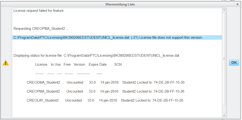

When opening Creo, I get a License error:
I opened the license file on C:\ProgramData\PTC\Licensing and saw, that this license was for Creo 2.0 ?!?!
The license file was created automatically during the installation process, and there was a success message.

    January 9, 2018
    1. remove all license files from C:\ProgramData\PTC\Licensing directory
    2. uninstall all pieces of Creo 4.0
    3. launch setup.exe and install Creo 4.0 once again
    4. use one of following Product codes
    K-12       students can use Product code BE410708EDSTUDENTEDK12
    University students can use Product code BK410705EDSTUDENTUNICL

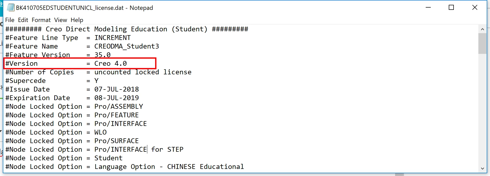

    Hi MartinHanak,
    I'm having the same issue. trying to install Creo 5.0 Academic getting the below error using the Product code BK410705EDSTUDENTUNICL and BE410708EDSTUDENTEDK12 both. The file shows Creo 4.0 as version. screenshots below. Please help I'm trying this for last 2 days and getting very frustrated
