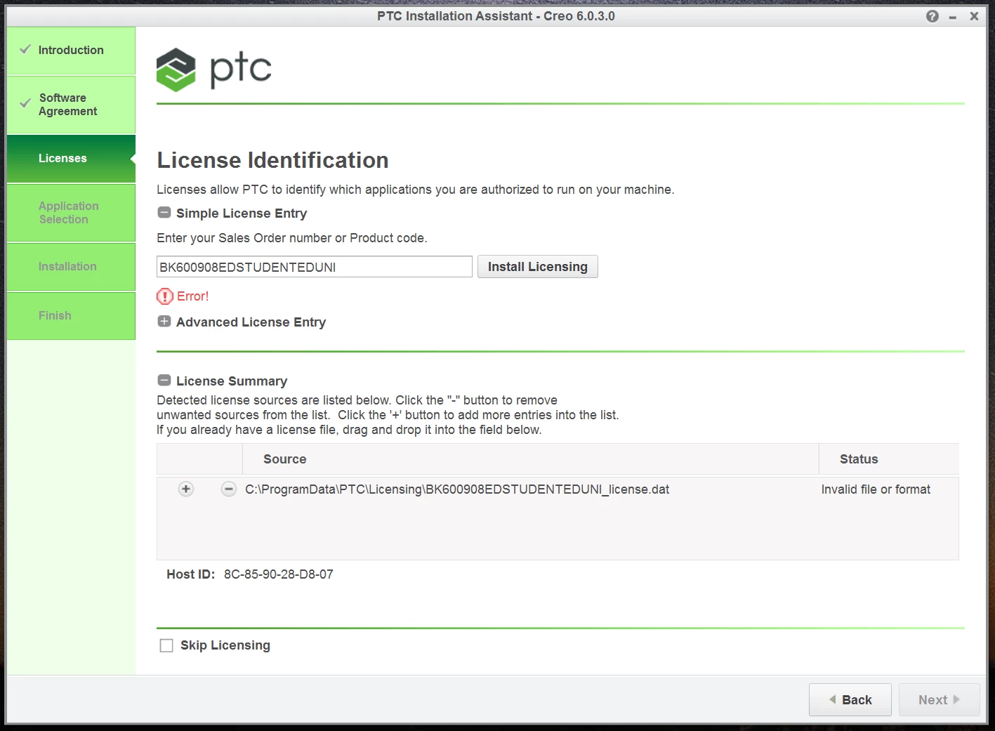

When attempting to use the product code BK600908EDSTUDENTEDUNI in the Simple License Entry in the PTC Installation Assistant, I am presented with a single "Error!" message and no details. I have previously used this license and was running Creo Parametric 6.0 with no issues for months on my University's network. Just recently, I moved to a different network and am connecting to my university network via a VPN and the license stopped working. I receive the Status "Invalid file or format" for my existing license that worked on the previous network.
How can I fix this license or download a new one for use on my home network?

I read through install_creo6_unistudent_standard.pdf and followed the instructions exactly. I have uninstalled all PTC products from the machine, removed all files from C:\ProgramData\PTC\Licensing and I re-downloaded the DVD image (MED-100WIN-CD-430_###_Win64.zip) to start from scratch. When going through the instructions, I get all the way to the last step but instead of getting a "success" message, I receive "error". There is no further information on what is causing the error.
4.]
I disabled all network cards and rebooted the PC before attempting to reinstall any software. I have attached an image of the error and the results of ipconfig /all > ip2.txt.
  • Do you have license file used in this era ? Look into old emails and into C:\ProgramData\PTC\Licensing directory.
  • This file contains MAC address ... is this MAC address available when you are connected via VPN ?
  • By default Creo installer fetches MAC address of local Ethernet network card -OR- WiFi network card. When VPN network card is available, Creo installer can be confused by this.
  • Please run ipconfig /all > ip.txt command in Command Prompt window and upload ip.txt file.
NOTE: Status "Invalid file or format" usually means that your license file does not contain license code. Please upload file mentioned in the picture.
