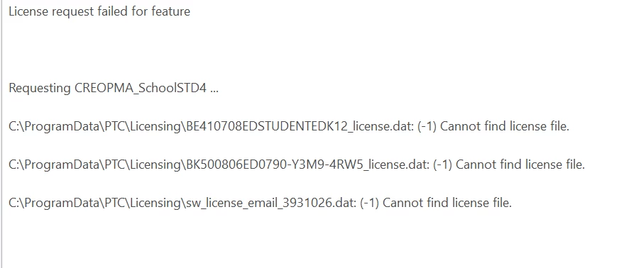

Having the same issue here, just tried to find the License directory and it simply doesn't show anything for me,
When I try using the product code: BK500806ED0790-Y3M9-4RW5 I get a error and telling me to contact license management?
When i try running the product code: BE500806EDSTUDENEDK12 i get this warning message Capture.PNG
April 25, 2019
1.] BK500806ED0790-Y3M9-4RW5 is correct product code (according to my records)
2.] in BE500806EDSTUDENEDK12 ... T is missing ... BE500806EDSTUDENTEDK12 is correct
3.] Creo installer does not like virtual network cards ... I suggest you to remove such VNCs and activate Ethernet and WiFi network cards (you can use ipconfig /all command to check current list of NCs)
4.] C:\ProgramData\PTC\Licensing must be empty when you start installation
