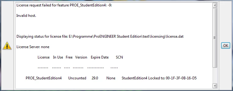

Because the computer, where I installed the program first time, doesn't work anymore, I want to use the program on a new computer. I installed the program at the new computer again. During the installation process I couldn't request a new license file because one was already taken. I tried it with the old license file but I think it is normal that it not works.
My question: What possibility is there to get a new license file (or exchange) or is there another way for further using the program?

Your previous license was likely node locked to your old machine. The only way to fix that is to contact a sales rep and get them to update the license which I can't see them doing for a student license that you are not paying maintenance fees on.
