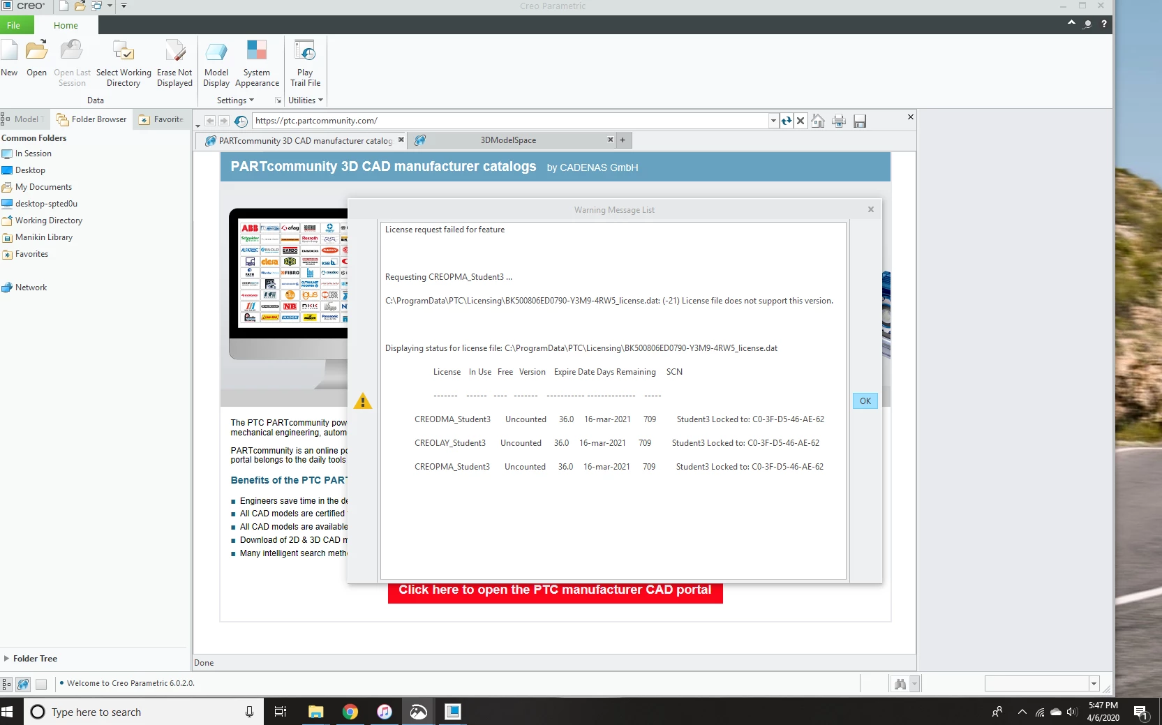

I am trying to use Creo 6.0 with the student code BK600908EDSTUDENTEDUNI and I get this error. I did receive an email of a file called "license pack". Is the code I'm supposed to use in that file?

you have to empty C:\ProgramData\PTC\Licensing directory before you start Creo installation. I guess that Creo 5.0 license file is located in it now.
