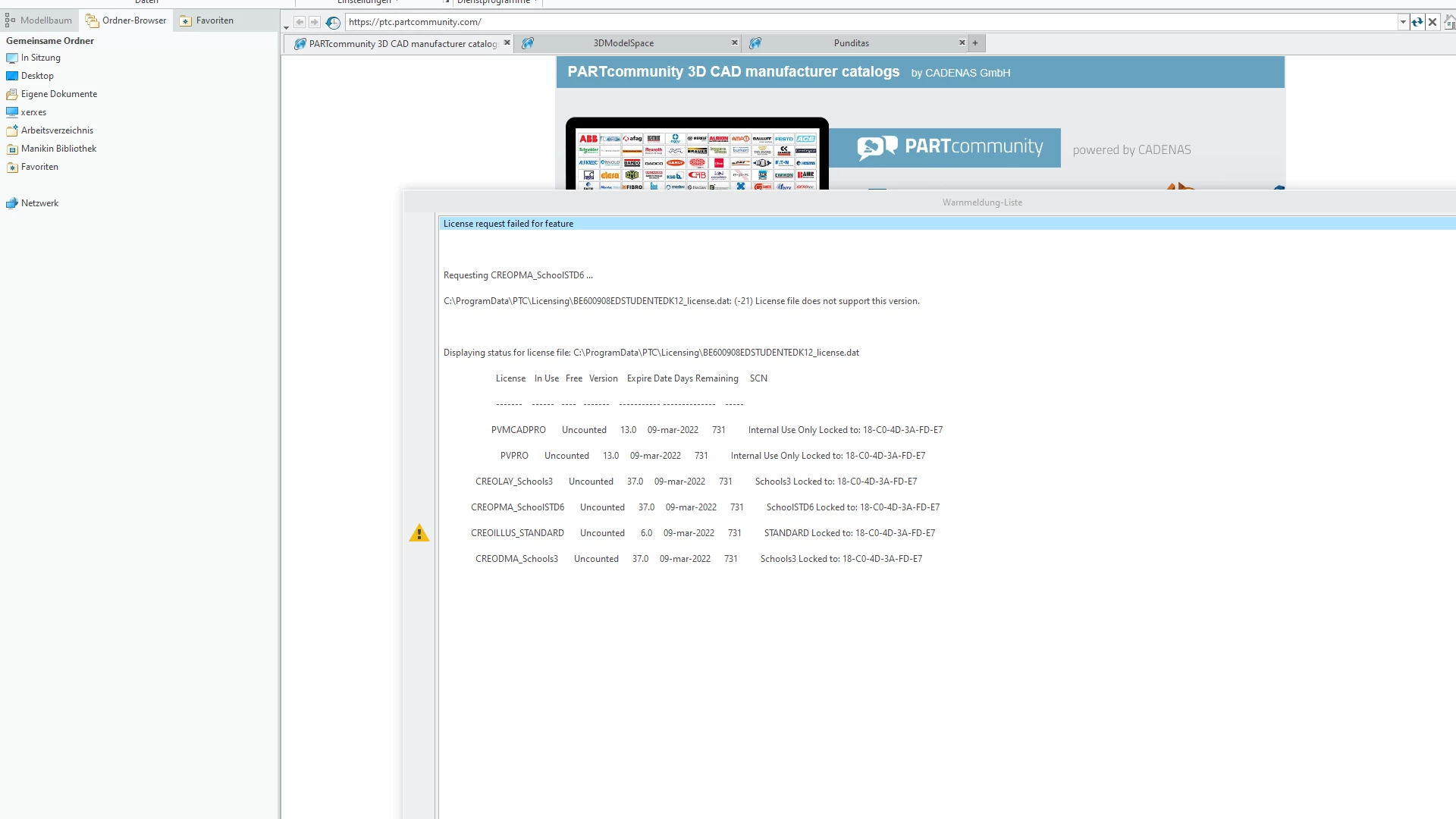

License request failed for feature
After i always got an error with the code BK700908EDSTUDENTEDUNI, i managed to install CREO Student Edition with the Code i found here in another topic, BE600908EDSTUDENTEDK12. Now i get an Error starting CREO parametric, which says Lichense file does not support this Version. Can anyone help?
Thank You and best regards 🙂
March 9, 2021
BE600908EDSTUDENTEDK12 is related to Creo 6.0, you cannot use it to install Creo 7.0.
Remove all files from C:\ProgramData\PTC\Licensing directory.
Install Creo 7.0 using BE700908EDSTUDENTEDK12 code.
