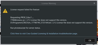

License request failed for feature

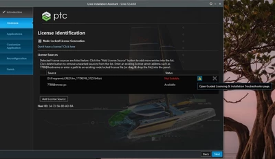

I am a student at the Faculty of Industrial Engineering and Robotics (FIIR) at the Polytechnic University of Bucharest. I have a license from my school, it is valid but creo 12.4.0.0 does not recognize it, i have removed it once and reinstalled it. Please help me.

Uninstall all Creo versions installed and run a fresh Creo 11 install.
Make sure you run setup.exe as an administrator! Also make sure that you turn off during the installation any security software that runs on your device, you can also get offline as you have a license.
Use the existing available license and don't try to add the server license in the client setup, it will not work.
First time you run Creo 11 after the installation make sure you run it as an administrator!

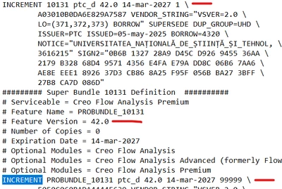

I guess your license contains Creo 11.0 license.
Open license file in Notepad and search for line starting with INCREMENT PROE_Educ1 ptc_d xx.0
xx.0 determines the Creo version
Creo 7.0	38.0
Creo 8.0	39.0
Creo 9.0	40.0
Creo 10.0	41.0
Creo 11.0	42.0
Creo 12.0	43.0
Dec 2, 2025 11:18 AM UTC
Do I need to change from 42.0 to 43.0 on every increment find or just to this specific one  INCREMENT PROE_Educ1 ptc_d?
