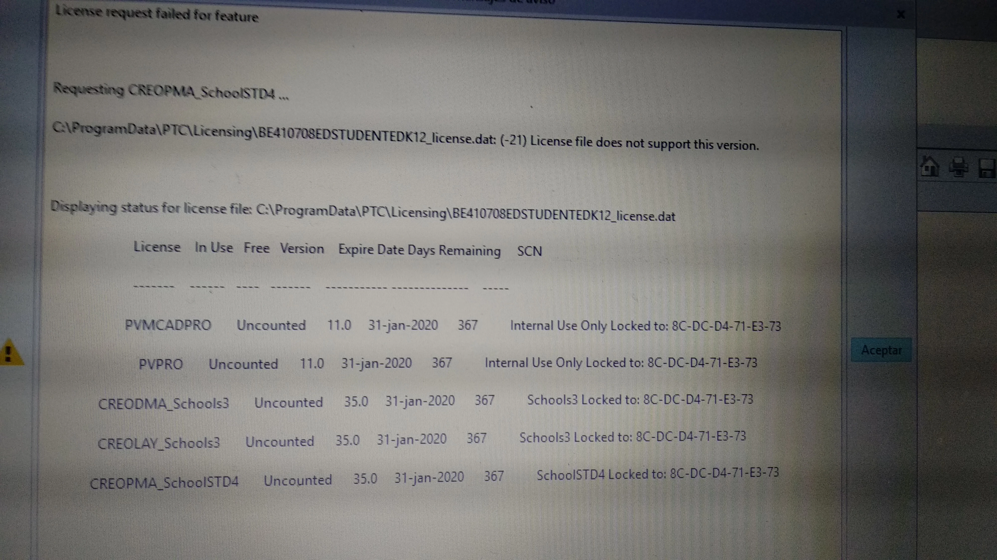

License request failed for feature
please could you help me solve this problem
Jan 30, 2019 6:00 AM UTC
BE410708EDSTUDENTEDK12 belongs to Creo 4.0.
I guess that you need to install Creo 5.0. If this is the case then use:
K-12       students can use Product code BE500806EDSTUDENTEDK12
University students can use Product code BK500806ED0790-Y3M9-4RW5
